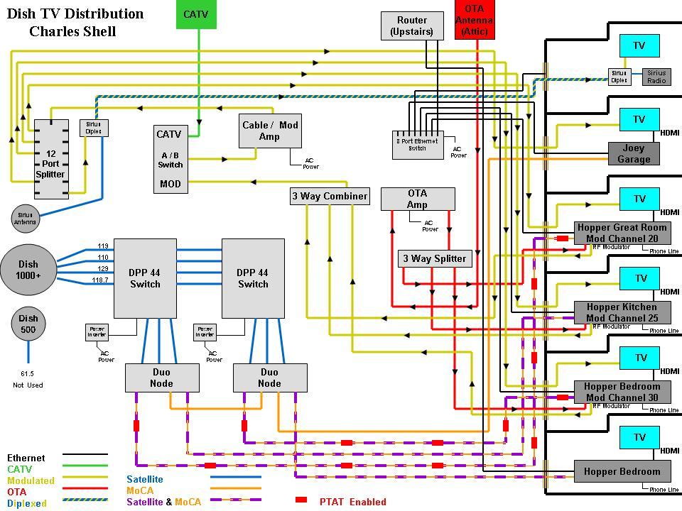

Yes, my Joey and all Hoppers are connected to my router by Cat5 and all are in Ethernet mode. The Joey seems fast to me. But the Hopper is a little faster. Yep, you are spoiled. LOL
Heh, well I meant just having the Joey connected to Ethernet with no coax. Or is that what you mean?
All my Hoppers and Joey are connected to my router and in Ethernet mode. All Hoppers and Joey are also connected by coax to the two Duo Nodes and jumper cable is connected to the two Nodes. I don't have any network issues. Maybe the Joey works better if both cables are connected. Can you connect your Joey with coax too and see if it runs a little faster?

Maybe sometime I'll connect coax to the Joey. I'll need to buy a tap though. I guess I'll know soon enough if it's the hardware when I get the updated Joey :) .
