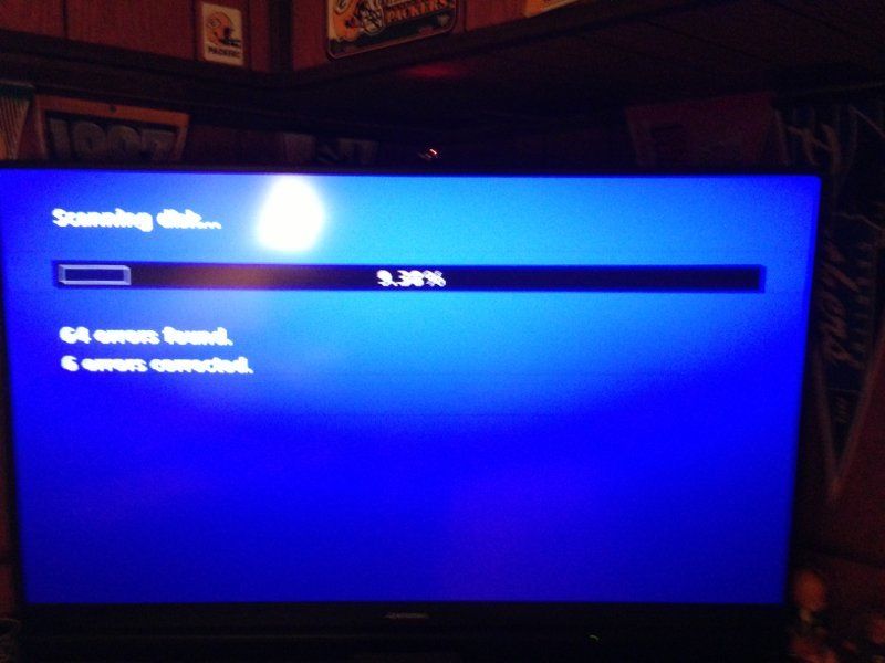

I'm getting a message on my HR34 just about every time I reboot it via the menu under reset. It looks to me like a hard drive issue. Any ideas? It's stating "Scanning disk... 64 errors found" it the same amount of errors each time.
Yes it does. It reaches 100% and then boots up normally after that. But the next time it reboots again, it goes through the same process. Never seems to really fix itself. This all started after the Genie feature was added to this box. I did call in and they are sending me a new box.
Call and tell tech support, that is a bad hard drive, especially with that many errors.
Timing is probably coincidental, as the problem is physical with the hard drive, not software related.
Timing also critical as with it being a HDD going out you could end up with no tv until its replaced if it craps out completely
Got them to send me a new box. Yeah, I would really hate for it being I have no other receivers with actual tuners in it. If that one goes, I'm sol.
