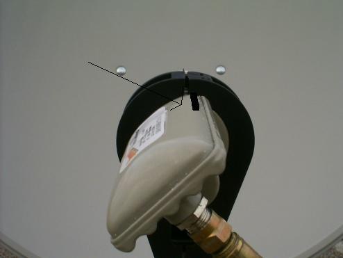

Here is a pic. On the right side of the LNB there is a notch that is the zero skew spot
old pic of one (I hilited the notch)

the arrow is located on the right side of the lnb,and when i have lnb pointing at 12:00,the coax input is at 6:00 pointing directly at the ground.
