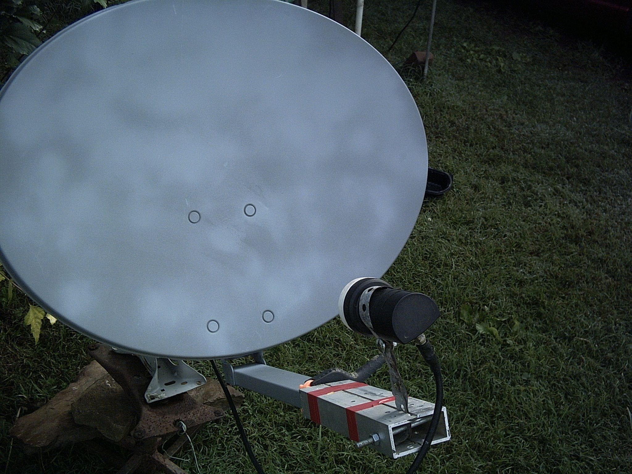

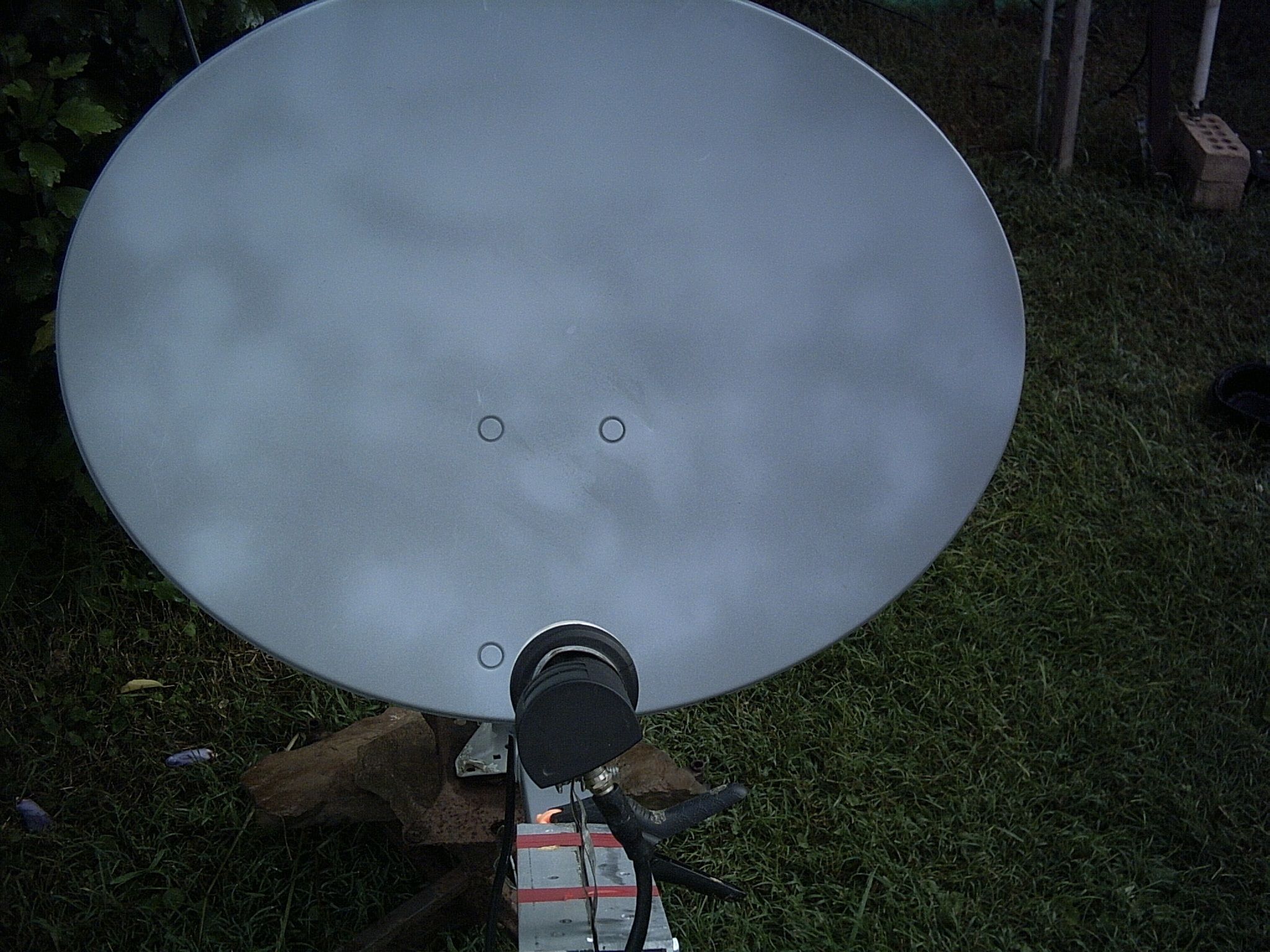

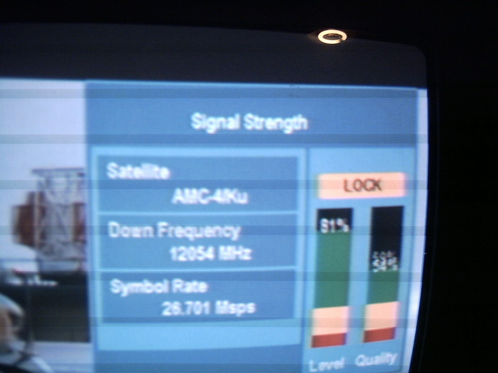

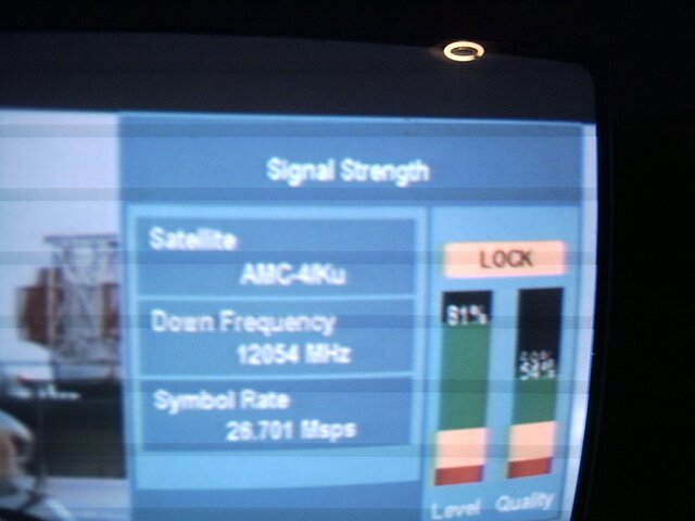

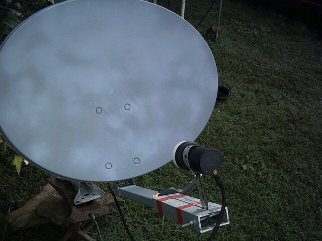

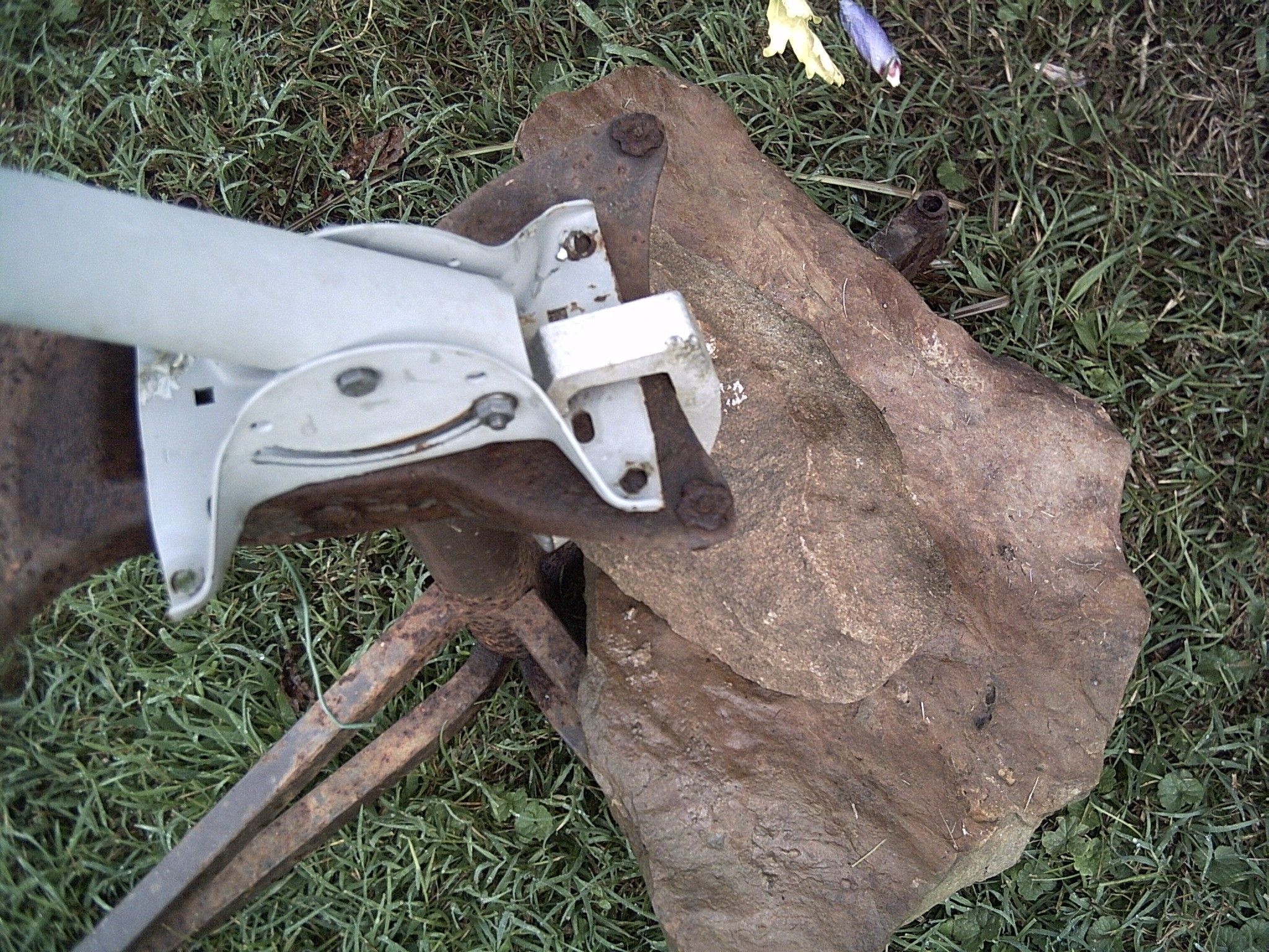

1. Retrieve dish from trash. This is a 25"x20" dish. 2. Throw away dss lnbf unit [very heavy; mine was already dis-attached]. 3. Clamp dish support arm down onto platform or secure to side of your house, etc. 4. Make an extension sleeve for arm holding the lnbf bracket. 5. Make bracket for lnbf . The lnbf should extend rearward 2.4 inches from leading edge of the arm. 6. Attach lnbf and cable. Adjust skew and elevation; aim dish. Peak when you have a signal [History Channel].
7. See pics. Think I will swing this dish over to 107 W for the 4:2:2 CBC news feeds and possible wild feed sports.
