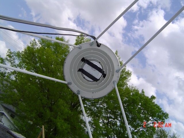

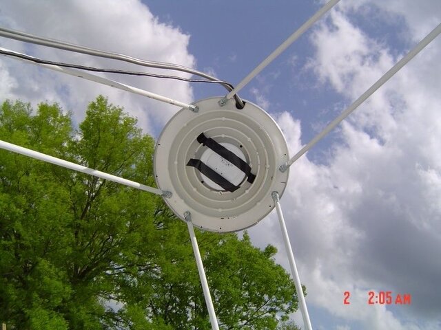

I was on the roof today to do some tuning on the solid Birdview, and thought I would take a couple of pictures to show you what I am dealing with to get Intelsat 3 at 43W and Hispasat 30W from where that dish now sets. :)
I can pull in IS3, but haven't gotten anything on Hispasat yet. I think it might pull in NSS806 too because it is just 3 degrees over. :)
The pictures are taken with the lens of the camera poked through the hole in the center of the Birdview, so it sees what the dish can see.
