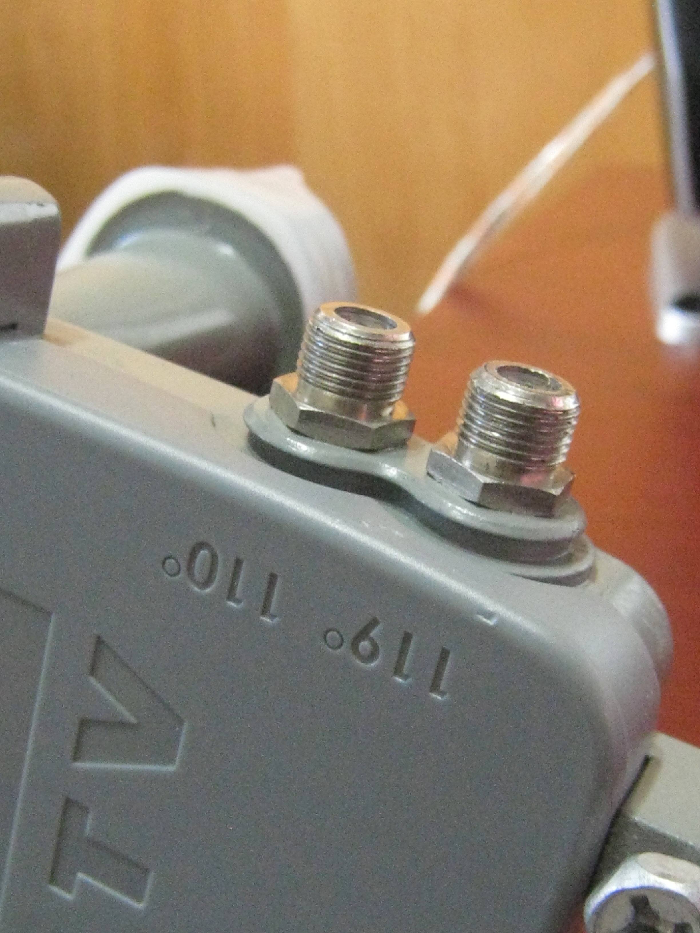

Anyway I have a DTVAHKAKUKIT which has a entrance for 119 on the side. Never tried whether it will work or not but could be a possiblity so u do not have to worry about joining with a multswitch or additional combiners....You can use one of these instead of any of LNBs you have on your 2.4 dish.

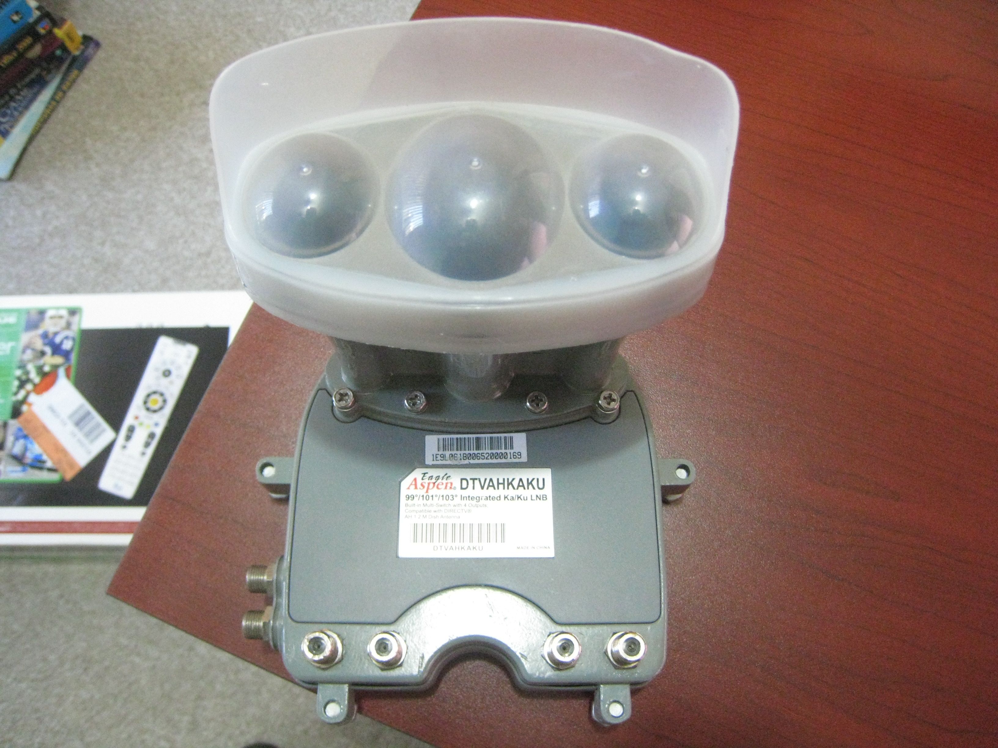

Wow I didn't know that DTVAHKAKUKIT has a entrance for 119. Would you have some picture of it?
thanks
thanks
Yes, I understand this is for a 1.2 Mt Dish giving the option of adding in 110 & 119 from a separate dish.

Thanks very helpful, btw, you said it is for a 1.2 mt dish, Is there a diferent part for a 1.8 mts dish?
Yes I know it it built for a 1.2Mt dish for Hawaii I believe...so the focal points should work for all satellites in a 1.2mt dish configuration, however, a 1.2mt dish is not enough in Mexico.
However, if you use it on a bigger dish (On 1.8 or 2.4)...you would have to point it to one of the satellite only (101 or 99 or 103). You could exchange one of you SL3 with this one on the 2.4 mt, I would recommend the 99 because of the stack plan & 22KHz tone, and then with other dish point to 119 and join into the port 119 of this LNB....In theory it should work.
Good Luck
