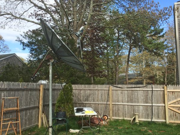

JFOK John, MS makes a good point here. Are you 100% sure your actuator is mounted the right way. I looked at this pic apex.jpg from your C-Band install thread and it looks to me like the actuator is upside down.
What model is your actuator? Could you take a couple of pics of it?
Kevin
JFOK John, MS makes a good point here. Are you 100% sure your actuator is mounted the right way. I looked at this pic View attachment 118659 from your C-Band install thread and it looks to me like the actuator is upside down.
Kevin
That IS upside-down. Clamp should be loosened, and motor should be spun to be on top. Then tighten it all down again.

That picture was taken early on while I was still trying to get the dish properly aligned.
I had since rotated it to having the motor on top, but had still noticed a bit of water in the box.
