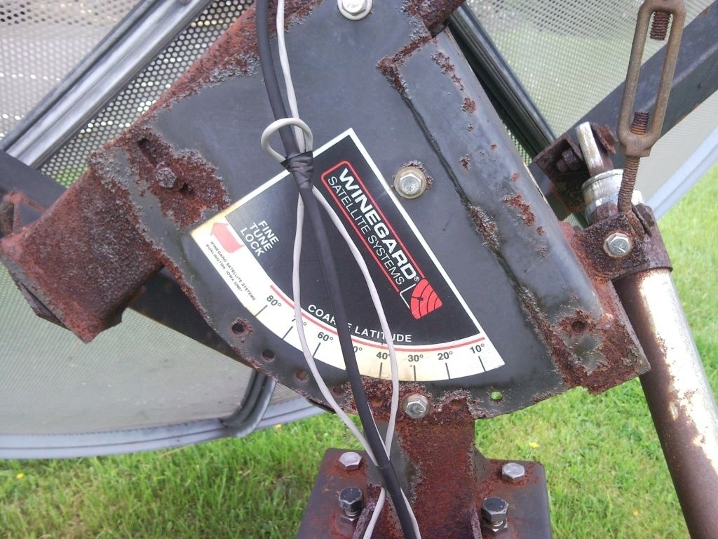

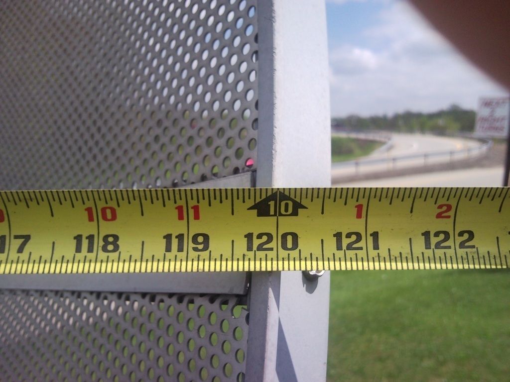

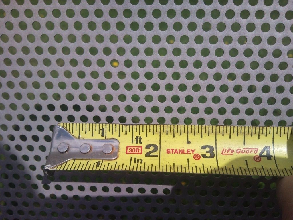

I can see it is a Wineguard and its 10' in diameter. The stainless steel mesh is in excellent condition, no deformities or blemishes that I could see. The mount has a bit of surface rust but I don't think that is a big issue. The pole is bolted to a concrete pad approx. 4" below the grass so removal won't be a problem. And it's a square pole, haven't seen too many of them in this forum.

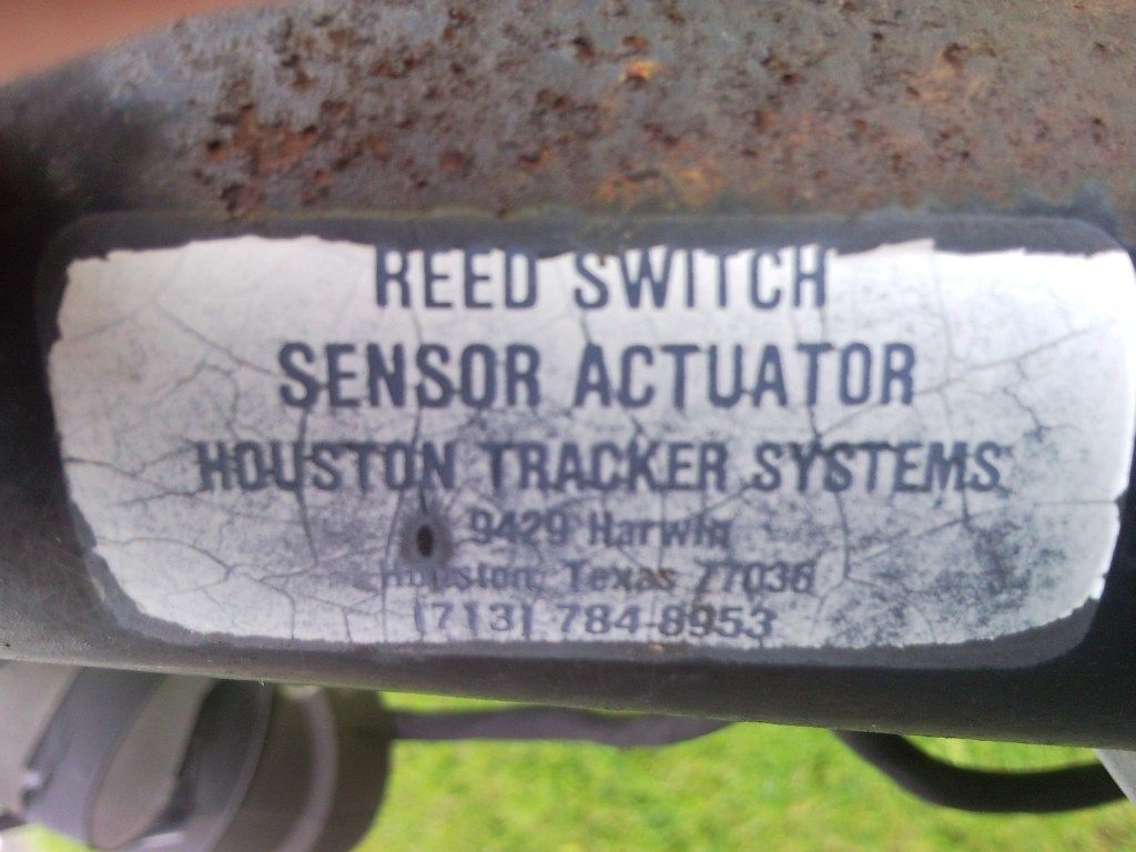

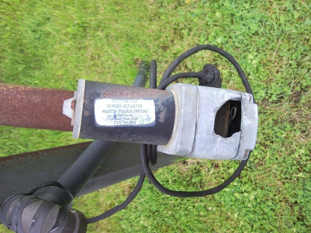

He said the actuator does not work but he doesn't know why. He quit using it about a year ago when he got "one of them small dishes..." He used some sort of hand crank to lower the dish to the position it is in now.

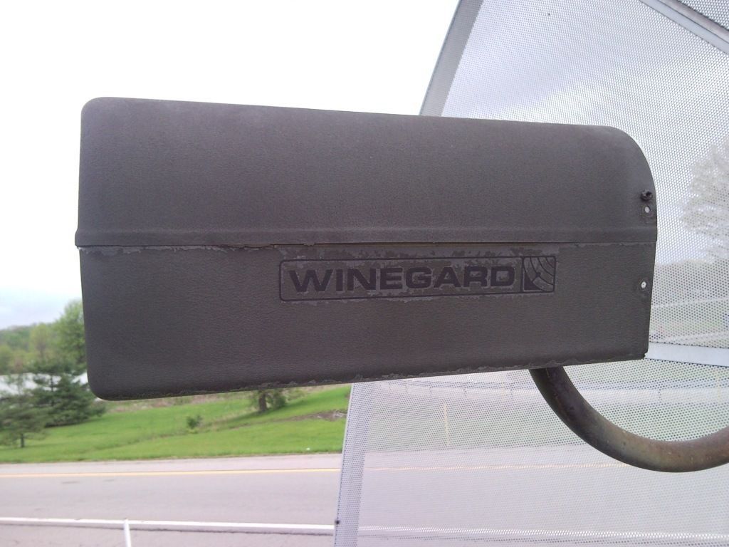

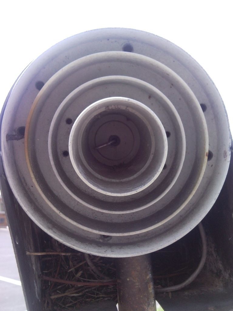

It looks like just a C-band LNB but I can't get any more information unless I pop the cover off.

From the pics the LNB looks like a C-Band only (the one wire also kinda gives it away)
The actuator looks kinda rough...a new one runs a little less than 100 bucks. Sadoun has them (just checked)
Thanks Ice!
Like I said I'm new at this but I've been lurking for a while. I don't know what size actuator I would need. At my new place, there is a website (dish pointer) shows that I can see from 5.0W to 148.0W. I realize that it's probably going to be less than that, but I didn't know if the actuator would be long enough to permit this big of a sweep.
Also, if you look at the 1st and 2nd pic, the LNB cover doesn't look parallel to the buttonhook. It kinda looks like it's offset from the dish too. Is this the way it should be or could the buttonhook be bent?

I always thought the buttonhook needs to be in the middle but with analog C-band there was lots of room for error. Not so much with digital.
I havent worked with a buttonhook setup so I'll let on e of the folks who have comment on it
Thanks for the response guys. What do you think a good price would be for it? And does anyone have any more information on whether the buttonhook is bent or is it supposed to be like it is (pictures 1 & 2)?

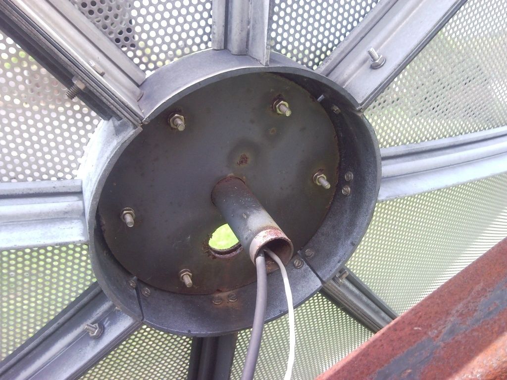

I have a 'buttonhook' dish. On mine the scalar ring faces right into the center where the buttonhook base bolts to the dish. I can not tell from the picture if the scalar faces the center of the dish. The cover (over the LNBF and scalar) obviously does not point to the center. Either way - I think the dish looks GREAT. If it is bent, maybe you could take it to a muffler shop and get it bent right. Good Luck!
I recently paid $100 for a complete Birdview, the Cadillac of dishes. Yours looks to be in outstanding condition, you may try to negotiate a better deal, maybe $50. Once you start looking for BUD's they will rain upon you. I have a 10' Channelmaster I got for free and another free one to pick up. The buttonhook can be straightened, or you can fabricate support arms from 1/2" emt .
