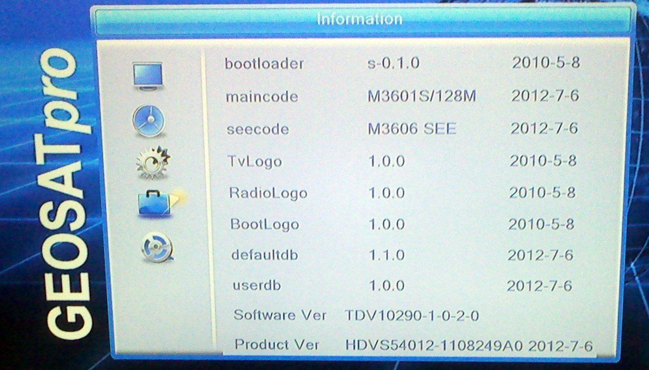

I've always had GREAT microHD service, and because of that, I never updated firmware. But, before winter, I'm adding some fixed dishes and want to make sure the unit is as current and easy to use as possible.
I'm a bit confused on whether my "version" of the firmware is the one we've been cautioned about that may cause issues. I refer to the fact my stored positions and favorites may not work jumping from this very early version to latest version.
Is there a need to put in an intermediate version along the way, and what version SHOULD I be able to go to from mine? I've read the update "sticky" pdf, but the caution is there that there may be issues reloading the user file.
May I politely ask the experts here, if my original firmware can go directly TO the latest, or what users here would recommend? I've not updated in the past year due to GREAT solid service, but it's probably time, especially if I want to continue being able to contribute to threads on this site should an issue arise. I understand the procedure, but don't want to introduce issues through updates if I need to do something in-between the original and the currently offered versions.
I'm probably the LAST person to not update when one is available!

You can go directly to the LATEST release.
What you can NOT do, (you will boot-loop the receiver) is reload your old .udf file with all your old settings, sats, and such.
In other words, IF you go to the new firmware, you MUST set it all back up from scratch as if you had just taken it out of the box brand-new for the first time. That would also be true even if you loaded intermediate version and eased your way to the newest.
Even with having to do it all by scratch, I HIGHLY recommend that you update to the newest firmware! It's all well worth it. Load it, factory reset it, then remove power for 30 seconds by pulling the power cord. Power back up, reset all your settings (time, tv, etc) Then select and rescan all your sats.
