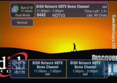

Great review Scott, I'm a new member, and the info on SATGUYS has beena great help. Have looked at TV2 with an HD channel selected? If so, is the picture squashed or in letterbox. Thanks again for the great review. Looking forward to a 2/21 install date.

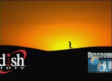

Ok I just tried this, I hooked up the output of TV2 to my Slingbox and put the 622 in dual mode.
The 622 shows the screen in 4x3 non letterboxed. (The sides are cut off)
Look at the pictures below (click on them for larger sized photos)
Hope that answers your question, thanks for being a SatelliteGuy
