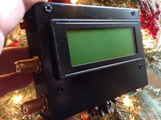

Flight Data Recorder for my dish

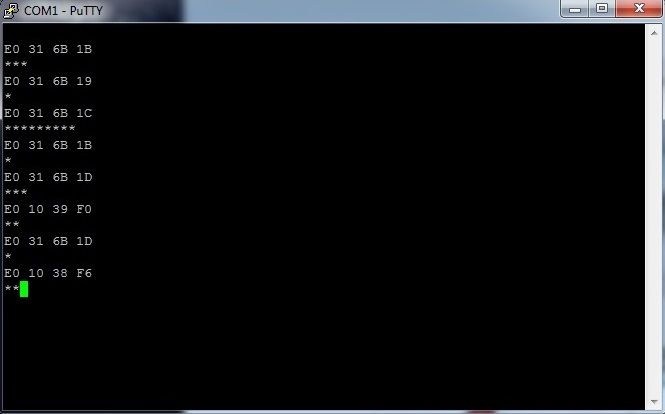

Do the asterisks indicate the number of times the string was reissued by the STB? For example: many STBs reissue the 22KHz/DiSEqC commands if the signal is not locked in an attempt to acquire or reestablish the signal path.
exactly right. In the case of MyTheatre the initial command(s) is issued twice without pause. The long string was a channel that didn't lock, an old game feed frequency. I also changed the command structure to include a DiSEqC 1.0, 1.1, and 1.2 stacked call sequence. All the commands issued twice to begin.

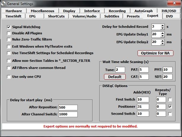

This new tool is showing me a lot about how the DiSEqC system works with my setup. I didn't realize I had so many options in DiSEqC control . I can set the switch type and number of repeats for the commands in the menu. I can select the framing byte E0 and/or E1. I can really make some custom switch controls with this :)
Ever heard the saying "The more you know the more you find out you don't know"? I've been studying DiSEqC specifications at Eutelsat. It's way more involved than I originally thought. Quite a language. I had no idea about some of the things you can do with satellite equipment. Ramping up the fun factor in my FTA hobby today :)

It was my use of the DiSEqC Decoder that brought to my attention the wide variety of commands and how complex that command structure can be. The "Expert Settings" in my setup allowed me to change the use of the repeat flag to enhance the possibilities of configuring switches and motors. As to what the meaning of the terms used on your receiver are, it may mean more to those who translated it than any one else.
