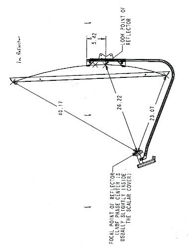

When you measure from the center of the dish to the LNB, just where to you pros stop with the measurement at or into the LNB?

The hard part of setting the focal point measurment is, where is the "Look Point" on your dish? Fortunately it's not as critical a setting as in C-Band dishes.

Since you own a 6' WSI Special dish like me , how deep into the scalar ring did you located the LNB. My LNBF is of a different brand (DMX-741), but maybe that would not make much of a difference.
My setup is working OK, but maybe it needs some modification and improvement for better reception and performance.

From Chapparals web site I used this chart as a guide.
The list below shows how far the throat is out from the scalar rings for different f/D settings.
EXAMPLE: A dish with a .42 f/D will have the throat about flush with the rings.
Inches — f/D
.12 —— .42
.32 —— .40
.52 —— .38
.72 —— .36
.92 —— .34
1.12 —- .32
For all the info see this page.
