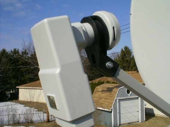

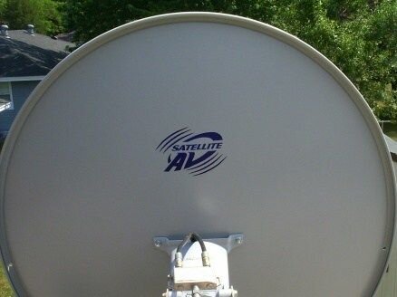

When I switched to a SatelliteAV 36" dish I thought I would have weight problems........ but my signals were still perfectly alinged.
Great LNBF and a GREAT satellite dish from SatelliteAV :)
