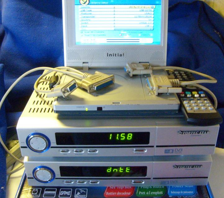

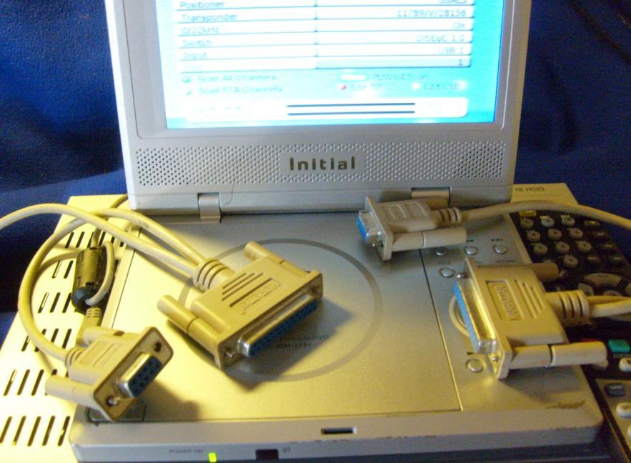

Has anyone had much luck cloning the software & channels STB to STB on a Fortec Star Dynamic? The book says connect a RS-32 cable to it, in which I done but it still says "turn on the slave IRD" on screen.
I know these boxes RS-32 ports uses NULL MODEM cables but is this feature done by a standard cable instead? I got a new Dynamic yesterday from Sadoun and it is getting installed for a friend tomorrow and I would love to clone the satellite list over to it from my Dynamic (Fresh Blind Scans on all Satellites from last night to today) to keep from having to do it at the new install location. Thanks for any input!
Instructions from the manual:
Firmware Download
You can transfer the firmware of your receiver to another receiver.
Please connect a slave receiver with a RS-32 Cable
Database Download
You can transfer the Database of your receiver to another receiver. Please connect a slave receiver with a RS-32 Cable
Page 18 under Operation
It says nothing about a Null Cable which I am using,,, and does not work! NADA!! :mad:

Problem Fixed!
The Fortec Star Dynamic Uses A Standard RS-32 Cable Not A Null Cable!
Good News! Changed the cable today to a Standard RS-32 Cable and bingo, the moved the Firmware and the channel list & Satellite scans over to the new Dynamic! :up
I used an old Windows 95 era RS-32 - Parallel Combo Cable which is a Standard Style on both connections. After looking for my three year ago Classic NA Cable I had given up, I never flash any of my STB'S since there has never been a reason too. So that cable is someplace here lost in the Twilight Zone and I figured if I found it, it would have worked!
After some looking through some old boxes of cables I found this one! Worked like a charm! So it is nice to know that us Fortec Star box users need a Standard Cable to make this feature work! Tried an old Coolsat 6000 Premium Cable yesterday (Null Cable STB Default Style) and it did not work!
Glad to know now I do not have to scan the new box all day today! The new one goes to a new home tomorrow; this saved very much needed time on the set up process!
The Firmware version on the Dynamic seems to be 2007 release. I noticed that my other box had 2008 and would venture to say that that is the latest.
So now I am off to the Fortec Star website to find the latest Firmware!!

True Radar, The cable I used was an old PC data transfer cable. It can do serial or parallel connections. It is the opposite (Crossover RS-32) cable than what the STB boxes require. (Not Null Modem)
The PC cable I used was one that transferred files from PC to PC in the golden age before USB!
It is odd but I feel it is just Fortec Star that does this. You need yes a straight through PC RS-32 cable to go "Receiver To Receiver" or using the Fortec Loader. I had no luck the other day using a Null Cable to use the channel editor for the Dynamic. I have not tried since yet but I feel that it will work now with the right cable!
So in short, yes you need a Crossover RS-32 cable to go receiver to receiver.
A proprietary thing I guess that Fortec Does and very odd! You would think that they all would be the same using a "Null" but I guess Fortec Star wanted to be different! :confused:

I could not get a Null Cable to work STB to STB! PC Cable yes!
Now what is strange is the Fortec Star Web Site Says this for the Mercury II:
Uploader - (Female-to-female 9-pin NULL modem cable needed.)
Channel Editor v.1.0 ( May 16, 2006) - (Female-to-female 9-pin NULL modem cable needed.)
I don't know, but unless a got a couple strange Dynamics, seems like they are wrong with the Null cable thing!
Have not yet had a chance to play with the Channel Editor yet with either cable. I will do that today sometime and let you all know what cable works with that!

I have boxes of cables too and just found that old PC data transfer cable that did the trick on the clone of the STB'S!
I tried the old coolsat Null Cable the other day and was not able to use the Channel Editor on any single Dynamic. Was strange but there was no need for me to go into it more after that so I never tried to push the issue of trying after that.
The boxes did clone fine on the PC cable I used just fine.
Now on the firmware, the new Dynamic that I got from Sadoun last week, it had 2008 firmware in it! I lost it cloning my last year's box by mistake (2007 version) to the new one. I would say there is not much difference between the 2008 or the 2007 version but I did find it odd that the new Dynamic had the 2008 version and I can't find it anyplace! Just the 2007 version! Maybe Sadoun can chime in here and tell us why! :)

I know the Coolsat 5000 uses straight through for Computer to receiver, but I don't know of any receiver that uses straight through from receiver to receiver.
To do so means that you are connecting the transmit line to the transmit line, and receive line to receive line, and somehow expecting it to communicate. It IS possible, but it would mean that instead of using off the shelf RS232 hardware and software, they'd have to design their own hardware and software. I find that really unlikely. But I don't own a 5000, so I'll leave it at that. I give up.
