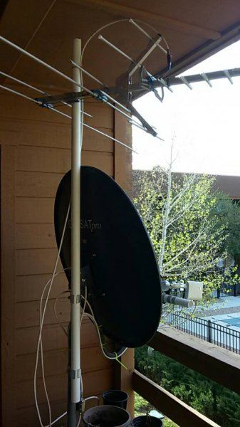

I haven't quite gotten 91 peaked, but ABC Newsone is coming in reliably. My wife bought too many plants, so I had to make some room and get the antenna up and out of the way. We'll have three cherry tomatoes, some beans, peas, basil, rosemary, peppers, potatoes, green onions, garlic, yellow tomatoes, and Colorado special :biggrin2. I'll clean up the wiring before work tomorrow.
The PVC pipe is an essential component of the budget-friendly tv setup.

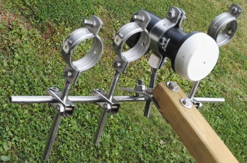

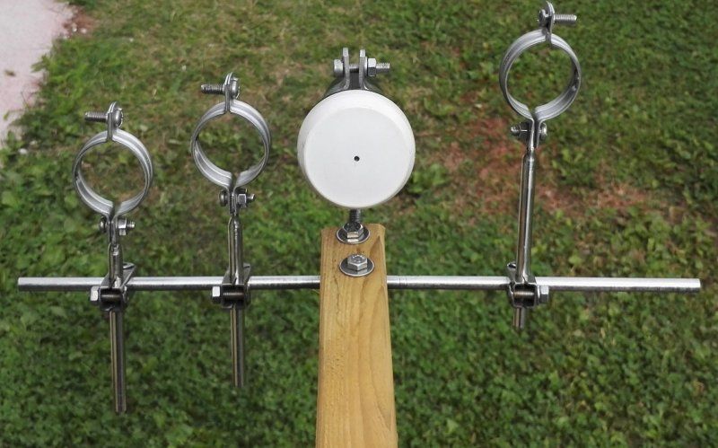

I was thinking a lot about building multifeeds and finally come to the solution as on the attached pictures. It is not so difficult to fabricate and allows to fine-tune each LNB independently. Also, depending on the clamp used any LNBF can be used (neck size 23mm-40mm-65mm). View attachment 131350 View attachment 131351

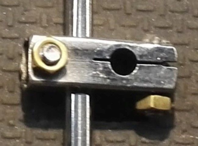

where the tubing crosses, whats the bracket called? Thanks
