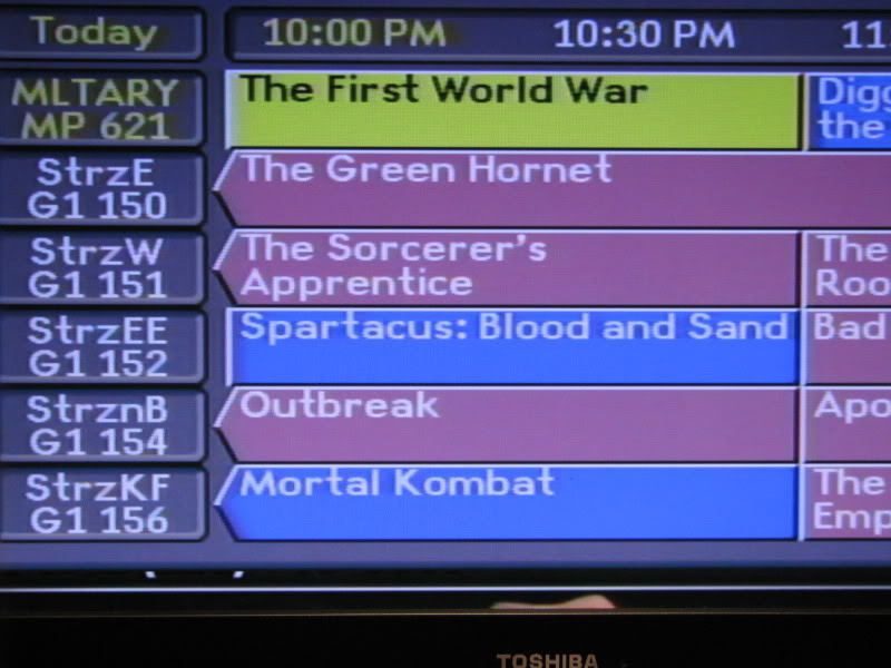

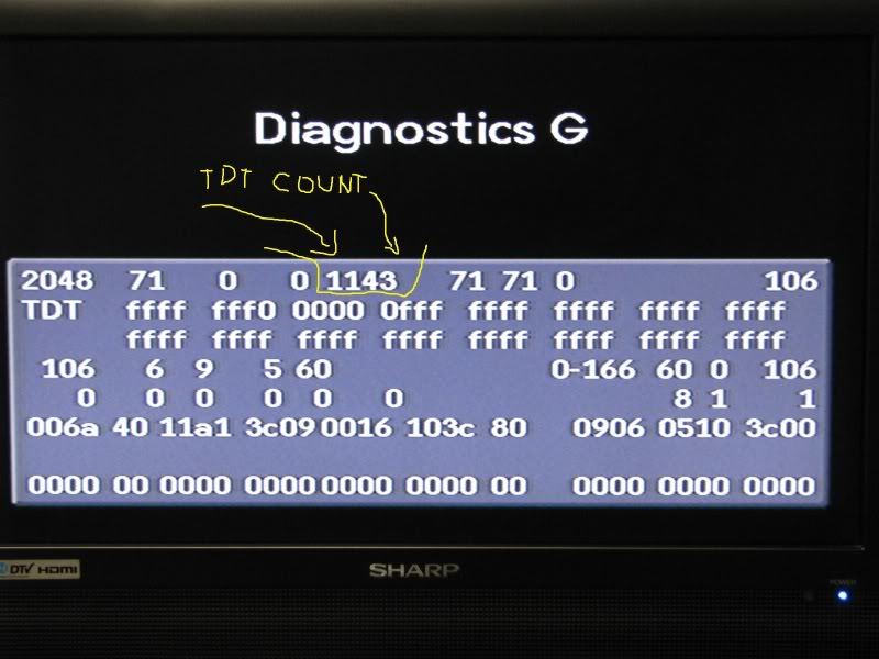

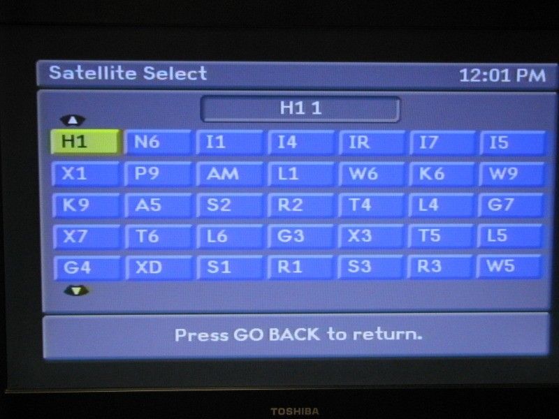

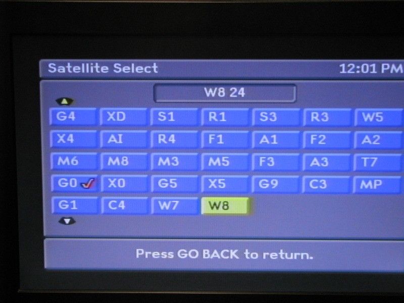

lets see:
some new map tiles in the new mappings here:
Limited guide info:
Low TDT count
Not too shabby!
