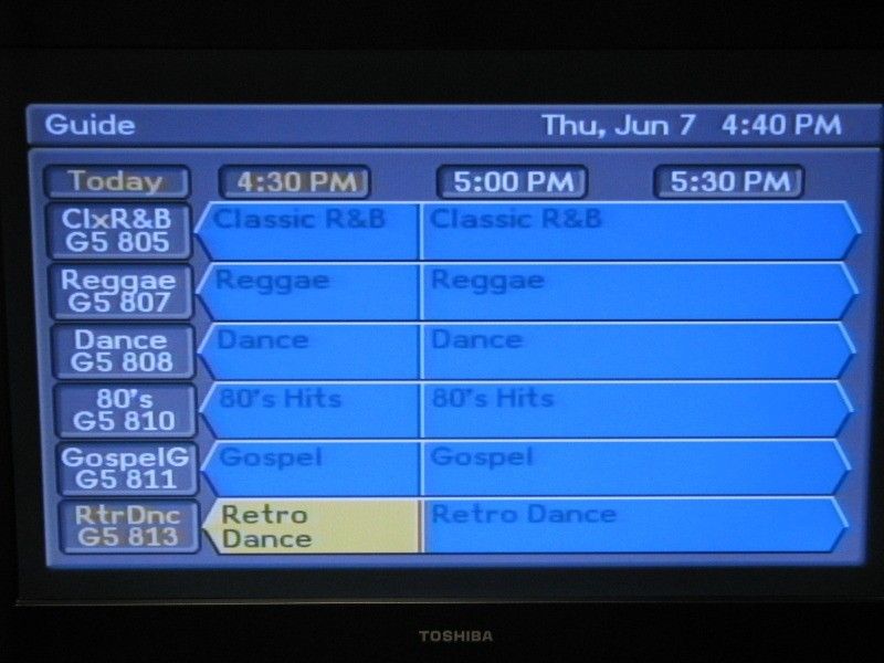

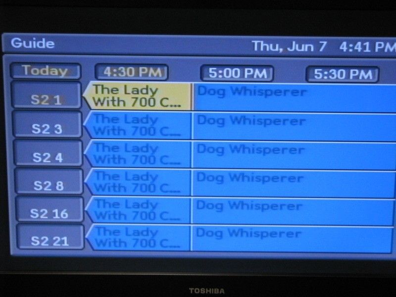

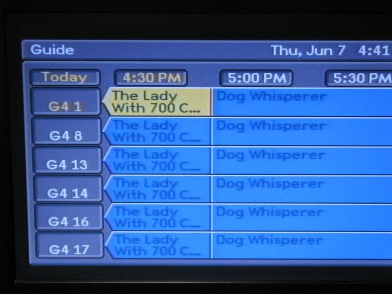

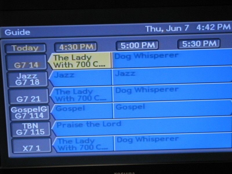

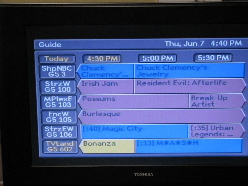

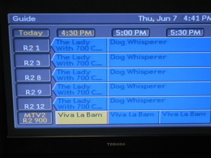

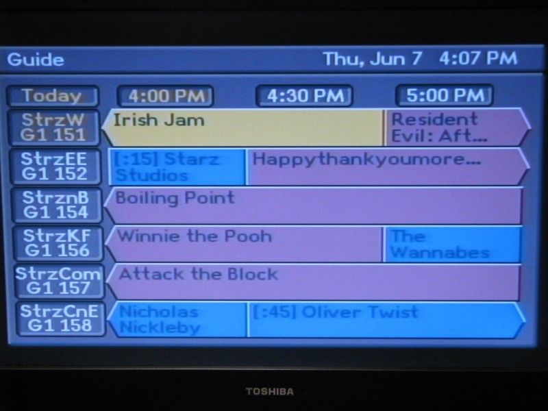

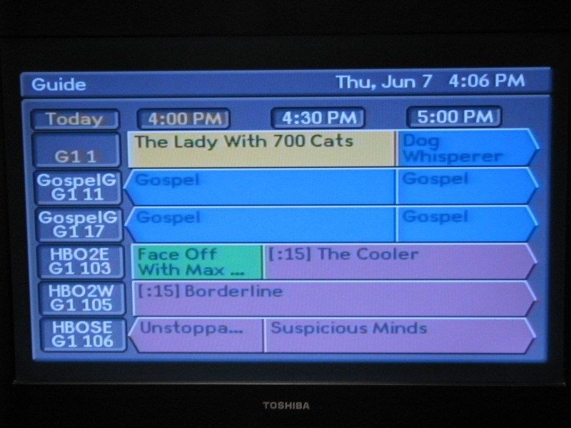

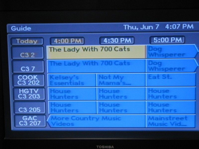

This is what the guide data looks like on a 920 receiver if you have a subscription to the guide with the maps we have made up.
Remember any analog channel would be numbered from 1-24
however with that in mind every Horizontal channel 1 or 2 was also listed in the guide for easier DVB use if the 4D receiver was a master dish mover.
even part time analog channels that had any analog video over the course of the past year were mapped in:
The G5 DMX Music Channels in the guide
Limited guide info was found so it is not on every channel that is up there in DC2 we had to go with what we could find.
On a 920 for analog channels the guide key shows up with no name on the channel but the guide data was for Nat Geo West. The 922 shows Nat Geo W on the channel. So it was weird things we find between the 2 receivers.
Remember there was no longer a guide code for O/V so the best was done with what was located.
So there you go for some interesting things that were figured out in the maps.
This made the guide button really useful once more but you have to have that sub to get the guide info.
It was like bringing the receiver back to it's original glory when it first came out.
