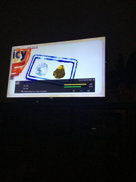

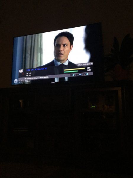

I tried 87w, but I've had no luck getting a lock on it with my 76cm. On the other hand, after 4 hours of fine tuning I was able to get a lock on 103w. I get 60%Q on NBC and 70%Q on NHK. I can't pick up NBC West HD. I can pick up all the other NBC's. Why can't I pick up NBC West HD?
Is 60% on NBC good for a 76cm? And, a completely off subject question. Is anyone not getting Taiwan Macroview on galaxy 3C?

I have another 76 cm fixed dish set on 103W too for NHK and that comes in good all the time, but the NBC feeds there don't always come in, the dish is a bit small for those.
How's your Q for NBC on 103w? Mines 60%
keep in mind that those NBC feeds are not always on. it's perfectly normal that at times, one or several of them show a blank screen.
