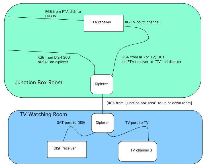

See if this makes sense.

can I add a splitter at the white area between at your diagram which is between the green and blue ares to feed two rooms??
also, in regards to the connection to the TV ( I know may be it is a dumb question) according to your diagram at the blue area, if you connect the diplexer to the tv, how you will connect the dish ceceiver to the same tv.
Thanks.
:confused:HI,
thanks for the reply,
No, but you can split the RF channel 3 from the FTA *before* the first diplexer and diplex it onto a line into another room. Then both would see channel 3. The reason you can't split it afterwards is you could be splitting the Dish signal also.
also, in regards to the connection to the TV ( I know may be it is a dumb question) according to your diagram at the blue area, if you connect the diplexer to the tv, how you will connect the dish ceceiver to the same tv. Thanks.
I was assuming your Dish receiver was connected via composite or svideo. If the Dish receiver is *also* on channel 3 then you would run the output of the diplexer to the RF or TV/antenna input on the Dish receiver and leave the RF output to the TV like it is.
It would be a lot easier to explain if *you* diagrammed what you have setup on your end.

Please see my attachement and let me know if I got it right.
You can't combine the DN & FTA satellite feeds on the same cable with a diplexer as they are using the same frequencies. (950mhz - 2150mhz) You can only combine TV channels (54mhz - 890mhz) with the DN or FTA satellite side. So you need to have the FTA receiver before the first diplexer and then put its output on channel 3 throught the diplex or splitter.
