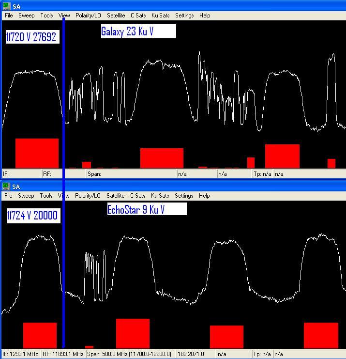

Here is the BLSA scan of 123 Vertical vs. 121 Vertical:

The weather there looks good now, if it was the weather shouldn't the signal be back to normal now? (Unless their uplink dish is slightly out of alignment)
