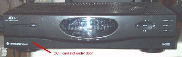

That slot was for the VC2 RS descrambler, if the *VC2+* got hacked they *GI* could send you a card to update it. There is also a card slot under the door on the front bottom left. This was used for the same thing except for the integrated DC II descrambler.
