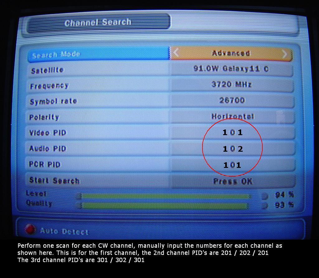

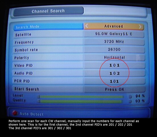

I don't know about the SV Elite but the typical two options are to do an individual scan of that 3720 freq and manually input the PID's for each of the three channels. this is providing your stb allows manual PID entry, take a look and see if it has the option in maybe an "advanced" mode of some sort. You have to scan once for each channel, the first scan must have the PID's 101 / 102 / 101, this will bring in the first CW, the second scan should have 201 / 202 / 201, and the third 301 / 302 / 301

Here's a screen shot of my Coolsat advanced scan menu, follow the instructions.
