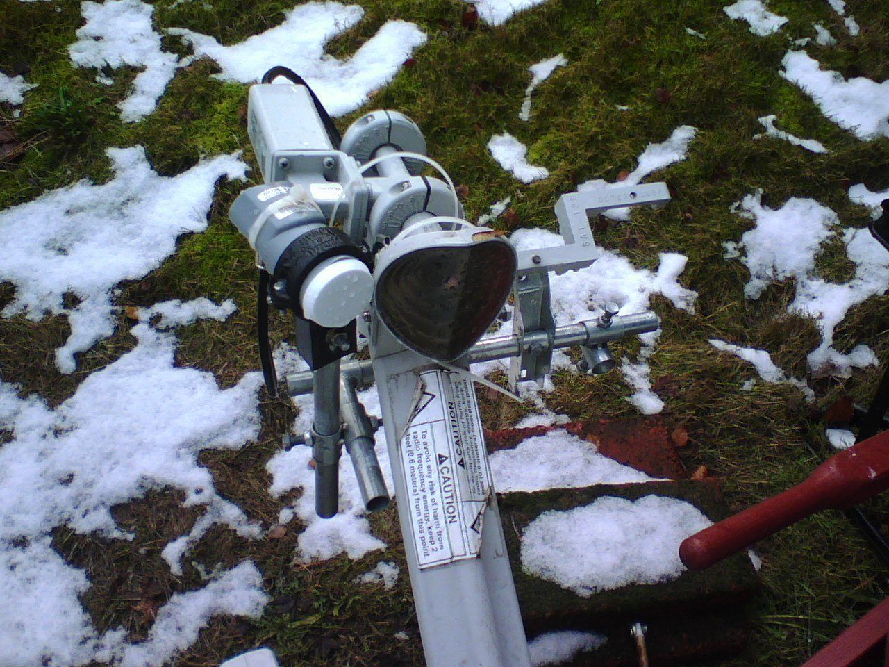

EDIT: Okay here is mine (since I don't think I've seen anybody try to do this with a C120 flange LNB as one of the positions)
The pic is of the LNB's looking from the dish
The overly large one is what I was referring to as a C120 flange
The smaller one is a Geosatpro UL1
123W is my True south.
Since these are at the top of the arc for me the satellites are spaced farther apart, making this easier.

I think I'm going to try adding 129 to my g18 dish. Is there any rule of thumb for lnb spacing?In this example 6 degrees would be so many inches, that would make tryng to find it a little easier.
That depends on the dish you're planning to use. The size and shape of the dish will change the position of the added LNB. Before making a bracket I'd just hold the LNB in your hand and see if you can pick up what you want first to see approximately where you'd need to position the new LNB.

I think I'm going to try adding 129 to my g18 dish. Is there any rule of thumb for lnb spacing?In this example 6 degrees would be so many inches, that would make trying to find it a little easier.
I've been known to take a ruler to pictures posted by other members (certainly some of Linuxmans, see below) and knowing how big his LNB is, measure the distance.
Then, knowing what birds he was shooting, it's possible to estimate spacing for other satellites.
