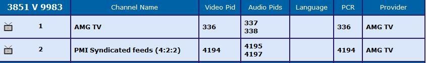

G-19 97.0W
3851 V 9982
AMG and pit path 2
AMG comes in fine no problems but when going to the 2nd channel in that mux,
pit path 2 channel, it comes up with what looks like a scrambled up video mess.
The Azbox pulls it in fine just by swapping out the input cable and HDMI cable.
The audio on the micro hd is fine.
This is the 2nd channel that does this on the micro.
The other one was on Galaxy 16 yesterday but that channel is not there today at all.
since this one is always on here has anyone tested it out to see if it is doing it for them.
I did check the pids and they were fine.
plenty of signal and quality so that is not the issue.
that 2nd channel is 4:2:2 which the MicroHD will not show on the screen You can record it and playback on a computer but since you have an azbox you could just use that ;)

I did not think that that channel was 4:2:2
and later noticed that 4080 V 29860 also came in the same way and that one I knew was 4:22
