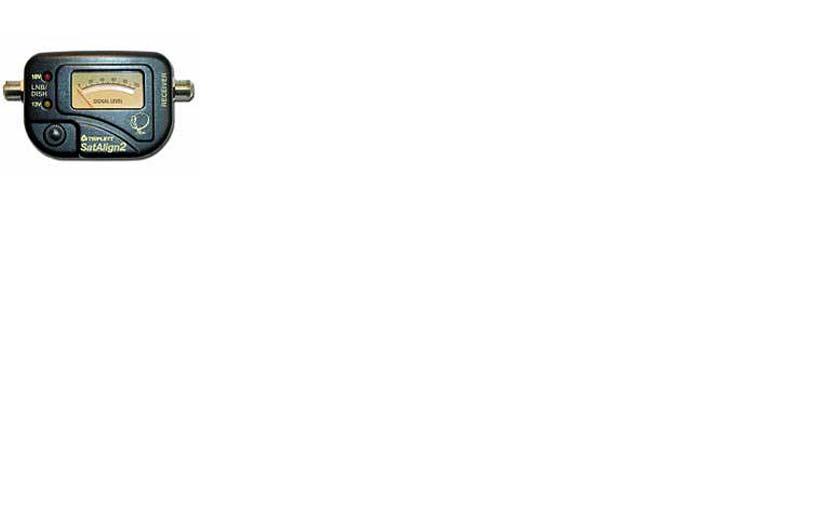

I want to learn how to use a satellite signal meter. I have a triplett satalign2. The meter has 0 to 100. 2 LED, red for 18V and Amber 13V. I turned the knob to low. Picture of the meter attached with this post.
Here is what I am doing.
1) Attach the signal meter as required
2) Turn on the Satellite receiver
3) Amber light turns on
4) Leave the needle at zero and fix my elevation to 51.7
5) Needle does not move
observation - If I move the elevation past 60 the needle moves between 80 - 100.
The red led does not light up unless I turn the satellite on and do blind scan for all H polarity.
How do I use the sat signal meter? Thank you for your reply.

I'll repeat myself on the satmeter
That satalign meter will help you with the initial aiming part.
Turn the knob 'til the meter squeals incessantly, even if you put your hand in front of the LNB (between the LNB and the Dish).
On my SF95c+, I have to turn the knob clockwise.
Now turn the knob back counter-clockwise 'til it's quiet again.
Now when it squeals as you're moving the dish about, you'll be on -a- satellite.
A satellite, not necessarily the satellite we want.
We confirm that your on the right satellite by watching the Quality bar on your satellite receiver using an active transponder.
For 97W I use 11789MHz V SymbolRate:28125 for aiming.

Sorry, I didn't read through the entire thread...
... and if you are getting the external meter to light up, you must at some time have LNB Power set to ON.
That would be necessary for most all simple setups like this.
No LNB power = no signal.
... and I'm sure someone must have mentioned to use a live transponder,
one with a strong signal.
See our own TheList for recommendations for each satellite.
1) The elevation reading from the sat finder was 51.7 but I had to move the elevation on fortec to past 70. Is this normal? Why is there so much discrepancies?
It is somewhat normal for the stamped elevation gauges on the dish mount to be inaccurate, but I've never heard of one being off by nearly 20 degrees. You are possibly looking at the wrong reference point. It is usually not where the bolt is (on some dishes it is), but rather the straight edge above it. It IS normal for these elevation scales to be off by as many as 5-10 degrees. Once you get a feel for aiming the dish, you never even need to look at the elevation gauge, except maybe to get the aim in the ballpark.
