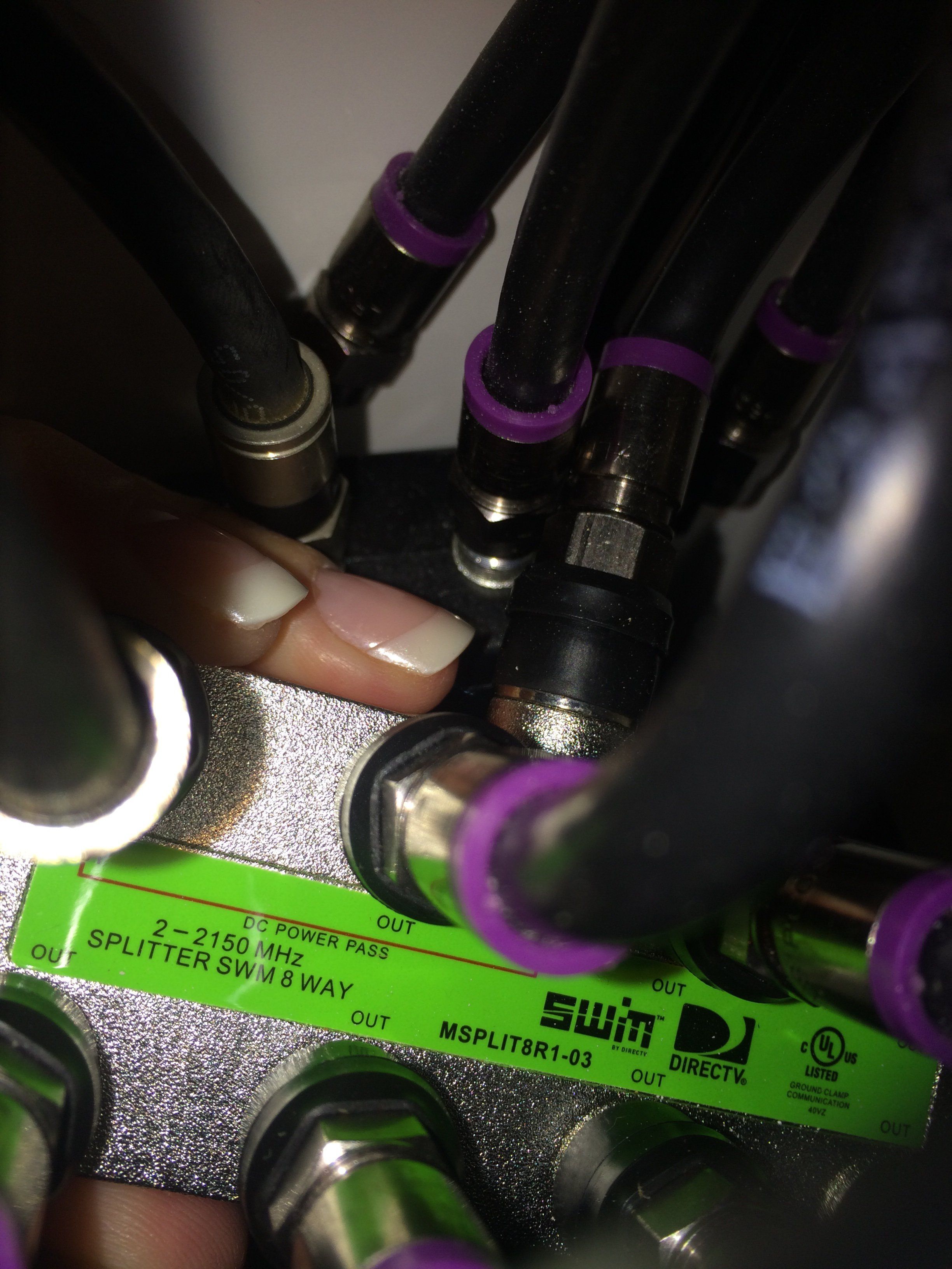

Do you have access to the swm switch? It has the model right on it, either 8 or 16.
Come to think of it, you may not even have a swm switch, you may have a splitter and a swm lnb.
It's really hard to say without knowing exactly what they installed on site.
I have previously went from a basic non SWM set up to a SWM3 set up and back to a Non SWM (LNB) and a SWM16 MS set up to accommodate my tuners ...
Yes, it gets confusing these days with the number of options available ... thers also probably more than one way to set this stuff up as well.
Counting the coax from the dish would help. With 9 tuners there should be 4-wires from the dish to the SWiM-16. If there is only 1-wire from the dish to whatever splitter, then the Genie upgrade was done wrong.

That's a swm splitter, which limits you to eight tuners in your setup. That means the installer wouldn't or couldn't add the extra three lines from the dish to where the splitter is to install the correct swm16 switch in it's place.
Alot of installers will turn off a tuner If installing the swm16 is going to be exceedingly difficult. But I always ask which dvr to set to one. Most ppl will not actually utilize 9 active recordings at the same time.
