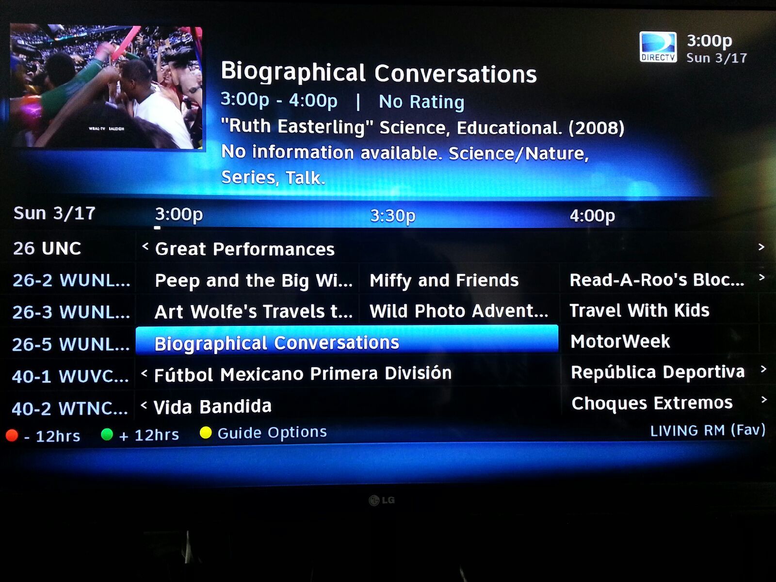

I know the HR34 scans for channels. YAY! But, does it still put channels you don't receive OTA in the guide? In the pic, 26-5 is UNC-MX, a Time-Warner cable exclusive channel. I receive it via TWC QAM, but no one gets it OTA as it was removed from the OTA channels years ago. I like having the guide info here for UNC-MX, and I am curious if it will stay or not.

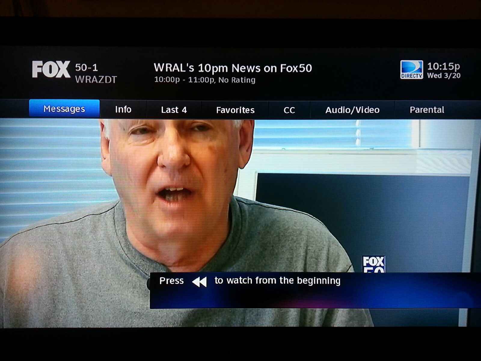

Also, on the client, a cool feature where you can re-start the program if you tune in late appears on select channels. This does not appear on any channels, including the same programs on the same channels, on the actual HR34 unit. Strangely, it appears on my non-local CBS but not the Directv-provided CBS.

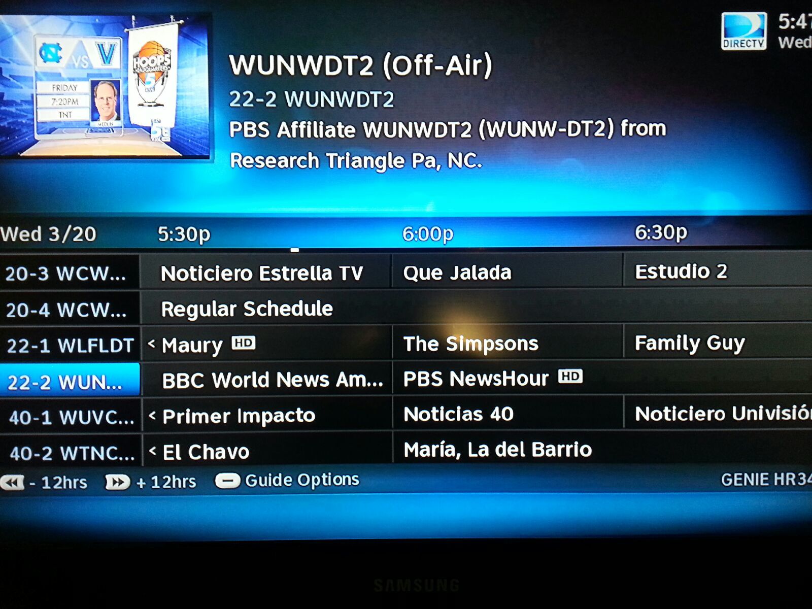

Even with the Genie, 22-2 is wrong. You'll notice it isn't WLFLDT2 that is listed, it's a UNCTV channel incorrectly listed as 22-2. (This particular UNC channel should be 27-2, which is missing from the channel 27 listings most of the time on the HR models.) Some reboots on the HR models list it as 27-2 and then there is no 22-2. With the Genie, I was expecting the "Regular schedule" message on 22-2, which is really Country Network. 20130320_174716.jpeg
I will try to snap a pic of the "press << to return to the beginning of this program" message.
it almost sounds like there is some bad guide info. Because the HR2X series loads channels regardless if you can get them or not (it goes by zip) you can see some issues. I didn the same thing when I got my HR34 and also had issues recently when I was testing something out.
You can try this to fix that
-do a reset on the OTA option to "clear out" all the OTA info.....guide will download
-then do a double red button reboot. RBR then it will load the guide. Then do another RBR and that will completely clear out the guide info
-Then do the initial setup for OTA
It will only find the stations that your antenna can pick up and download guide info (for the ones it has guide info for)
I dont have a client but I do see that message when I tune to a show I'm recording. But it only can go back up to 90 minutes (if recording a long program)
I have seen that pop up too if I am watching something from the hard drive and then I'm done. But that popup doesnt always happen
