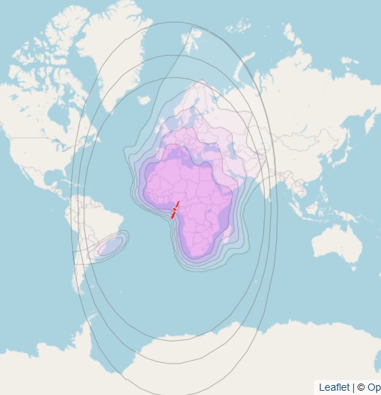

Good Morning and lots of coffee!
Check out satbeams.com. It will give you an idea of what you may be able to get.
Couple of things. If you live in Africa, you may be in luck.
FTA satellites do not transmit with as much power as the big guys. So usually a dish of 1 meter, 3 feet diameter. would be your minimum. Not sure of how many are doing it with a smaller dish. But it would probably be like a dog.
"Because they can", you know....
Waiting to see what others have to say when they shake off the cobwebs.
He's in Sioux Falls, SD per his post so Astra is definitely out of the footprint.
