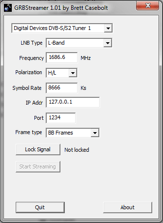

I have uploaded GRBStreamer 1.01 to my website at: http://naturalgfx.com/GRBStreamer101.zip
Differences from previous release:
1) I changed the way the 'Lock' button works. Now when you click 'Lock' it sends the command to the card and returns immediately without having to wait before you can do anything else. It should lock eventually. If it doesn't you can click 'Lock' again any time. I am pretty sure this is the way many other programs do it. A background process will continuously update the lock status.
2) GRBStreamer 1.01 automatically saves and loads your previous settings. All except for the Tuner Card selection.
3) I fixed a bug that would only affect TBS cards. Using a TBS card, for every packet of data coming from the DVB card there was a 1 in 24 million chance that the program would corrupt the stream. This has been fixed.
4) You can also use GRBStreamer with a TBS card to stream NOAAPort. The Digital Devices card does not work with NOAAPort because its ACM, and the card only supports QPSK and 8PSK.
Thanks for the update!!!
Have add version 1.01 running since last night, and no issues, not even a bad sync error. I did noticed that it took a bit longer to lock with the TBS5925 (using the coax reset method) as compared as before, but is all good. I don't mind it. :)
Will be testing it soon with the DD.
I'll leave v1.01 running as long as possible to see how it performs on longs periods of activity, before switching to v1.01A, unless you see a reason to go to rev A sooner.

Rev A is only for NOAAPort. It reduces NOAAPort Sync errors from 1 in 4000 to 1 in 500,000. But I just found a way to reduce them to near 0.
I will probably make another release soon, but I want to see if weather01089 has any problems with it.

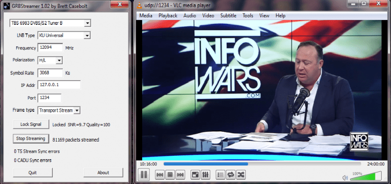

I have updated GRBStreamer with some bug fixes and changes. You may download the new version 1.02 here: http://naturalgfx.com/GRBStreamer102A.zip
1) It no longer causes the streamreader.log to fill up fast with error messages when using a Digital Devices card. GRBStreamer was trying to use functions not supported by Digital Devices.
2) The grbstreamer.log file now contains more useful information. If your card has two tuners, it will keep two separate log files (one for each tuner). This was necessary because sometimes there multiple instances of GRBStreamer running.
3) The streamreader.ini file now has the line "FrameMode=1" commented out. This is because CrazyCat said it was not necessary to use FrameMode=1. The frame mode is detected automatically.
4) For TBS cards, the status line now displays the SNR and Quality.
5) There is a new streaming mode - "Transport Stream". You can use this to stream live video to VLC (see screen shot below).
Here is GRBStreamer 1.02 streaming "InfoWars" on 99W to VLC player:

6) For NOAAPort streaming, the sync error rate is now zero. (Previously is was 1 in 500,000). Also, some software expects each NOAAPORT Stream ID to be sent to a separate port. Currently GRBStreamer currently sends all APIDS (101-108) to the same IP port. A future release of GRBStreamer may be able to specify individual ports for each Stream ID.

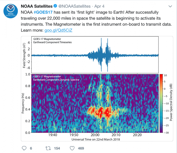

GOES S updates are often posted on Twitter under the '#GOES17' hashtag. Here's a link: #goes17 hashtag on Twitter
Looks like they have successfully activated the magnetometer and have received its data (screen shot below). I think I read somewhere that they expect to be streaming from all the instruments by about May 15th.
