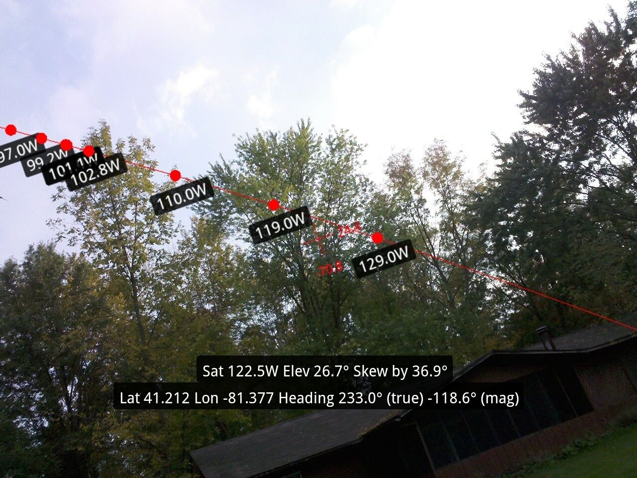

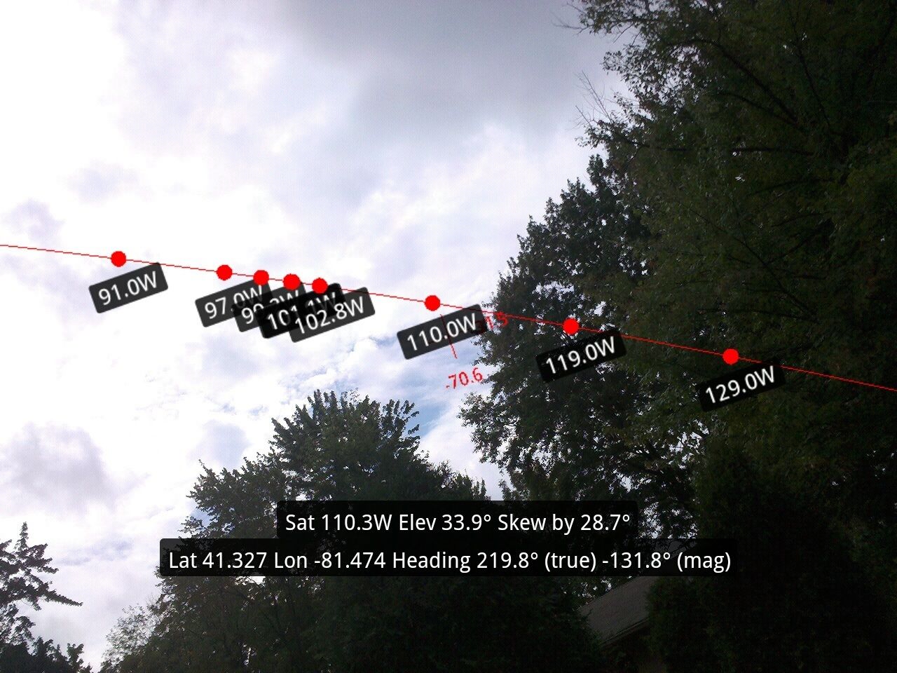

I used the dishpointer app on my Droid and took some setting of out new house and i even went back to our old house and took some settings.
In the following photos you will see both old and new house have very the same LOS issue
Here is the settings and view from our old house using dishpionter, It was taken just below the dish.
As you can see there are many large trees in the LOS for all D* Sats
Now here is the settings for for our now house.
As you can see here i only have a problem with the 119 sat.
Now i remind you all, In the first photo there are trees in LOS. But i had never had a problem getting a good signal and always had great HD.

It sure looks by the pictures you posted that you should be able to get service at your new house, except for the 119 satellite. The rub is, why could you get signal at your old house based on the picture you posted. I have heard that the dishpointer app isn't always accurate. Maybe it's a little off in both shots?
Well your 1st picture I believe is wrong. The reason I say that is where I'm at (up north) we have a 41 degree angle so by judging from the house in the pic I don't see it. App may be wrong, I'm not sure. As far as the 119 on the 2nd pic it could be an issue. We're required to have 10 degrees on both sides of the "birds" for tree growth and wind (blowing limbs). I don't think you'll have issues as long as you stick with the LNB3 and just do without the 119. Hope that helps
It's dead on the spot here in north east ohio.
I even had a friend that works at nasa here in cleveland come out with the good tools that nasa uses.
The old house is dead on and even the new house is also dead on.
What i don't get is at the old house we still got good number on all sats even the 119 going through the trees.
Alot depends on when you were using it as well as the amount of leaves on the trees.
Your only using the 119 sat when your watching your international channels for the most part.
Theres not much else on it.
The rest of your programming is coming from the 99, 101 and 103 Sats.
