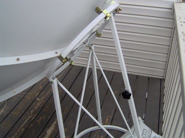

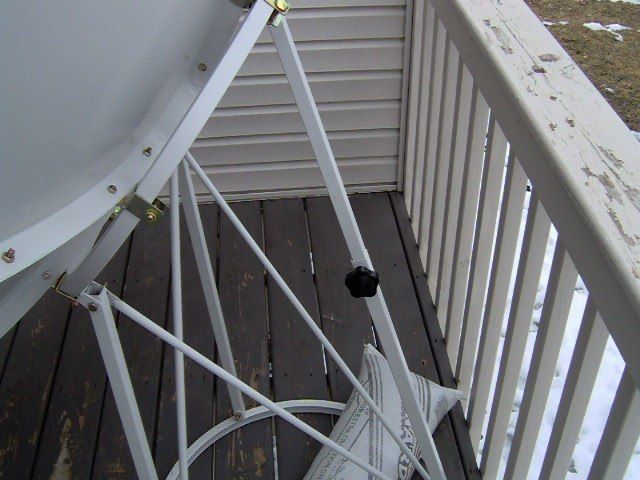

pictures of the base on the back
Its just a couple "O" rings and a couple pieces of metal that all get put together. The back bar with the know adjusts elevation
The reason for the sandbag on the back is 38 degrees the dish seems to get a little top heave and wants to tip forward 1/2".This prevents it

You need to get it up as far as the railing, maybe a table the same size for now would work?

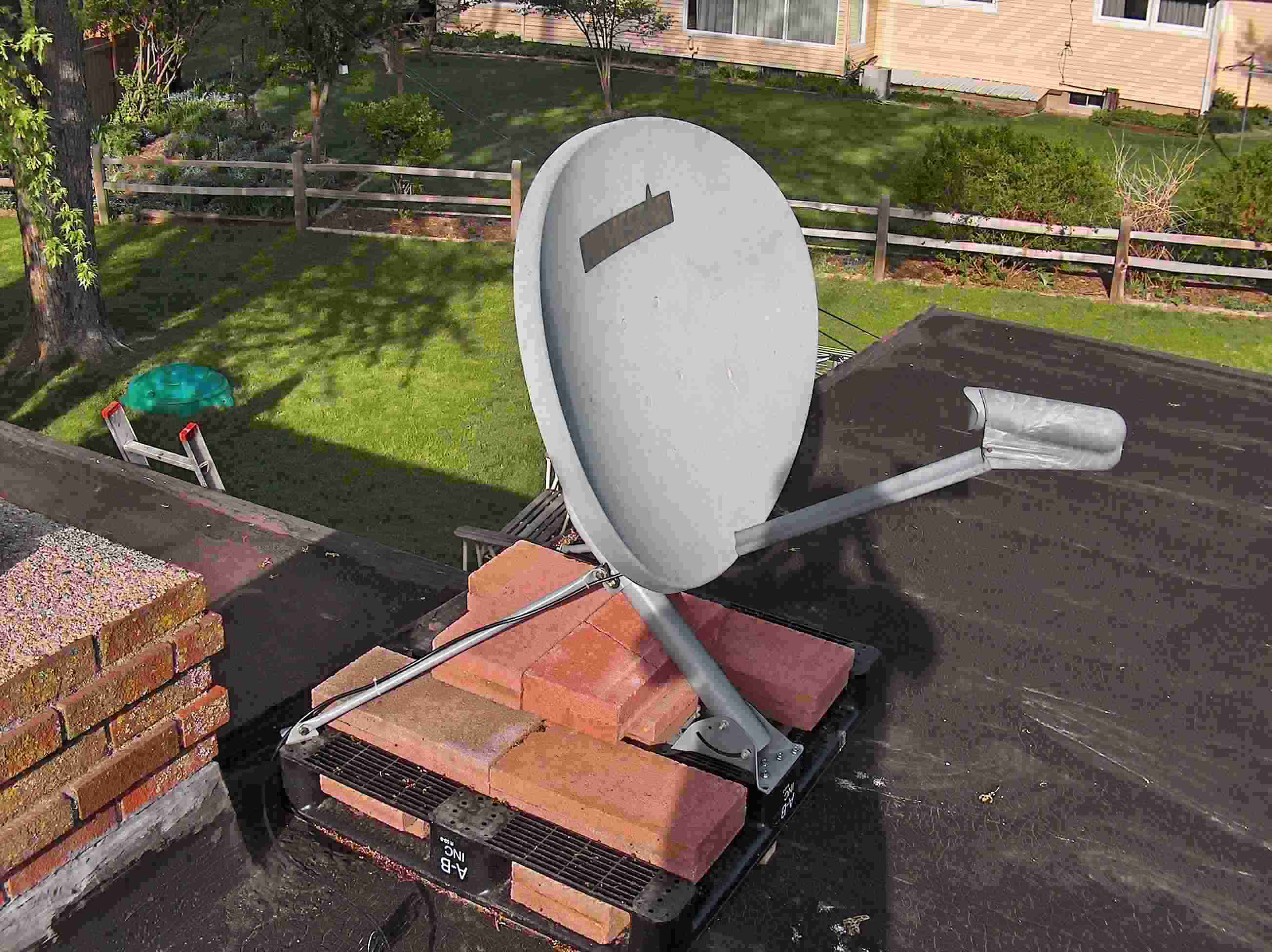

Ice I know that my homemade non-penetrating mount is only a 3 x 3 plastic beer skid but maybe you could use a 40 in x 48 in wood (or Chep 4 by 4 )would be very heavy duty. It's great to see the progress that your C Band system is coming. Mike
