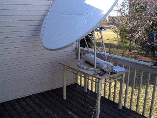

So everyone said "go up"....well I did (for about 15 minutes). I didnt have the spool yet so I tried something close.....my kitchen chairs :)
They are 17 1/2 off the ground so I put them right next to each other, tossed the sandbag aside (well not toss...the thing weighs 70 pounds) and lifted the dish on top of the chairs. Tuned the dish to analog (still had to hold the dish with one hand and tune with the other) but got Horizontal really good..

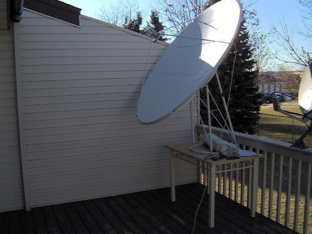

Well tried some more tonight and major accomplishments :)
Took my computer tabel (which is an old kitchen table) out there...This stands 30" high....moved the dish and put the tabel in that spot and hoisted the dish up there. Put the sandbag on for weight and away we go

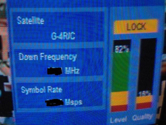

so I moved back to G3 and scanned and got in the Equity mux and a whole bunch of feeds. Now here is something weird. The Equity stations were at a 45-46 on the Pansat, yet they kept breaking up. Threshold for KU is 30. Got a lot of feeds (black screen though) with signals up to 90
Moved to IA5 and got the Pax station pretty good. (50) BYU came in at 20 but it was there
Now the main one...G4

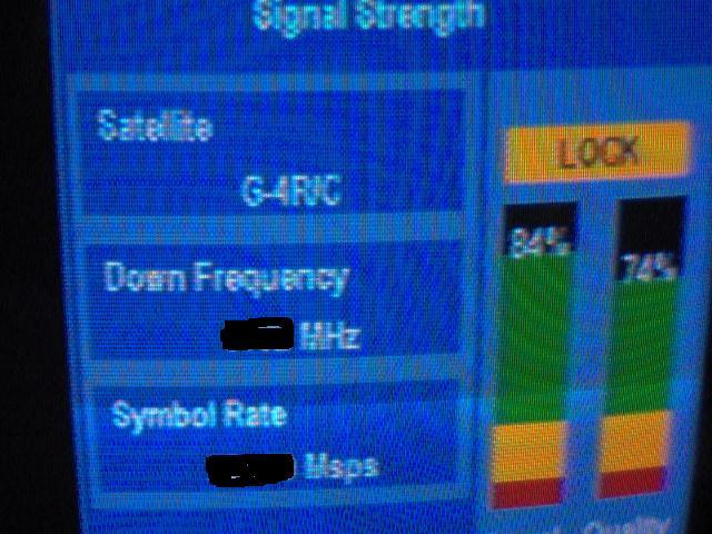

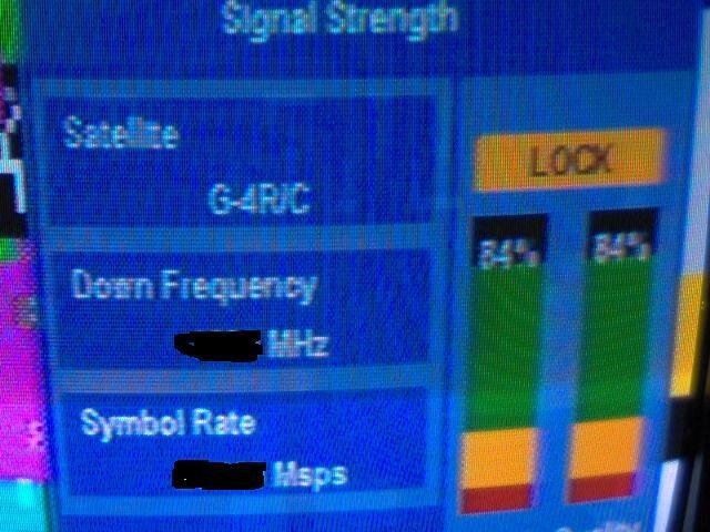

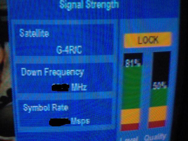

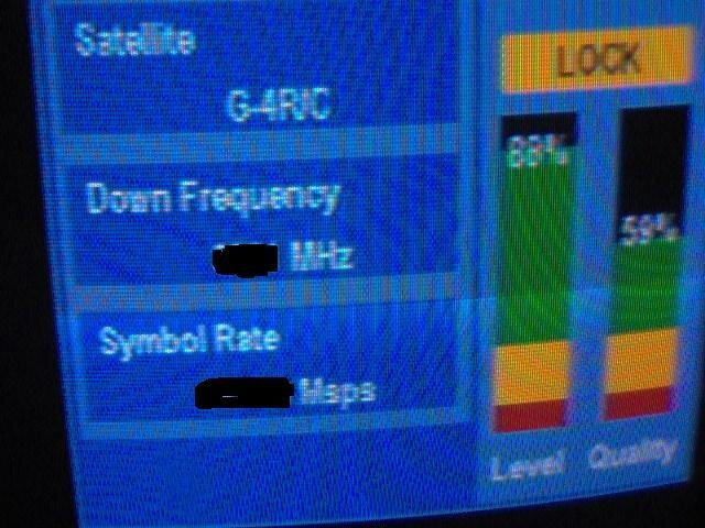

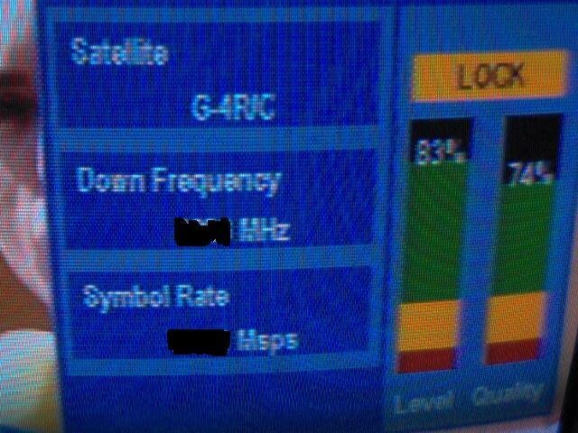

Locked it in and climbed on the ladder to fix skew. The Networks came in at a solid 30. Whats weird is the signal drops to 15 but its still stable. Did a H scan and BAM BAM BAM feeds galore...while I was waiting, on analog the MN state lottery daily numbers were being picked so I got to see that :)
Vertical was the same amount I had before.....so everyone is right...go up higher and it will work. Well yes it does. I did take it back down because I want something sturdier :)

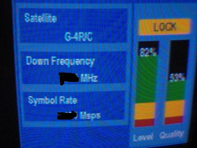

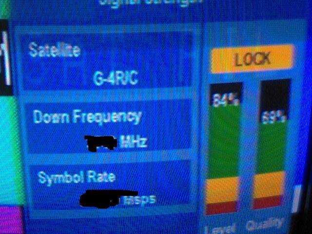

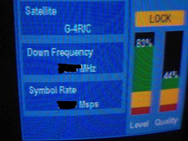

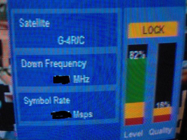

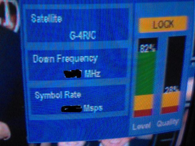

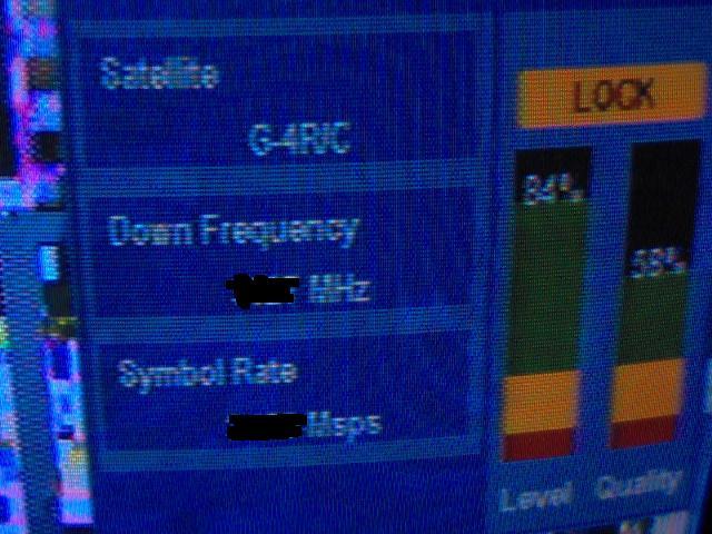

Here are some pictures. First two are of the setup and the rest are the signals on feeds (info blacked out)..most were Horizontal but the last 3 were vertical. As soon as I put the dish back down, all the H went kaput and the V dropped to 45
so we're getting there :)

Looking good! I would get as far away from the wall and a bit higher, the height of the railing looks good!
Glad to hear its working out now for ya!
need a more stable way to make it go higher...now that its up that high, wind might be my enemy
What about a round table ;)

Glad its working Iceberg! Gotta wonder about those Equity transponders though... that's a big part of my desire for C-Band, to get back the 'ol Tube! Its strange that they're coming in with good quality but are breaking up. Equally strange is the fact that lower quality than 30 signals are not.
it is weird....Equity was maxed at 50 and that was stable. signal drops to 45 and breakup city. Same with a couple other transponders (Pax on T5, BYU on T5). But on G4 everything was fine. I was amazed that the networks at a 30-32 were stable as can be. The vertical feeds quality was mazing (75-88)
even though I only went from T6 to G4 there is a lot on there :)
You may want to check what level of FEC (Forward Error Correction) is being used. It is possible that Equity is not using as much as the ones that lock with a weaker quality. I haven't looked as I'm watching my 18 month old this morning before going to work later ("work" is a lot less work.... hmmm.... silence..... what is she doing now?)
