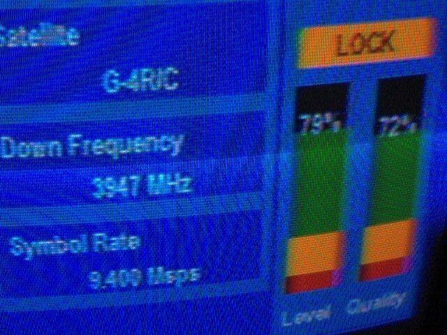

was working on the C-Band tonight and I noticed the quality was low...only a 32. Now its been raining here for 4 days (Friday-Monday) and been windy so I figured the dish was out of whack.
So I hooked up the Pansat and went to work :)
leaned on it going East and 45...ok we're back to normalcy...so I shift the dish east and I see it spike to 55 and then back to 45...huh
move it a little more east and solid 55 with a spike to 70....huh...this is a joke, right?
move it a little more east and I thought my deck was going to collapse under me jumping up and down...
yep...SOLID 72-75 on the Nets with the "oh it won't work it's too small" 6 foot dish :)
I am soooooooooooooo stoked :D
proof (it did max at 75 but the damn Pansat meter is so finicky)

PSB said:
Someones happy
understatement there
dishMIKE said:
There is absolutely no better feeling than to see that quality meter jump up !!!!!
I know. whats weird is it never budge off of 47 max any other time I've worked on it (and Ive moved the dish over to IA5 and then slowly moved to G4)
Iceberg said:
WOOOOOOOOOOOOOO HOOOOOOOOOOOOOO!!!!
I take it this is the sat you were wanting to hit ? :-)
Wyr
Probably has to do with the harmonic balance of the North Sea . :-)
wyr
Wyr
uh, yeah...its in my signature
I mainly wanted the nets so I can pump a combination of the nets on G4 and Equity stuff on G10 to the other rooms :)
yep. I didnt change anything on the LNB last night...just nudged the dish a little east
