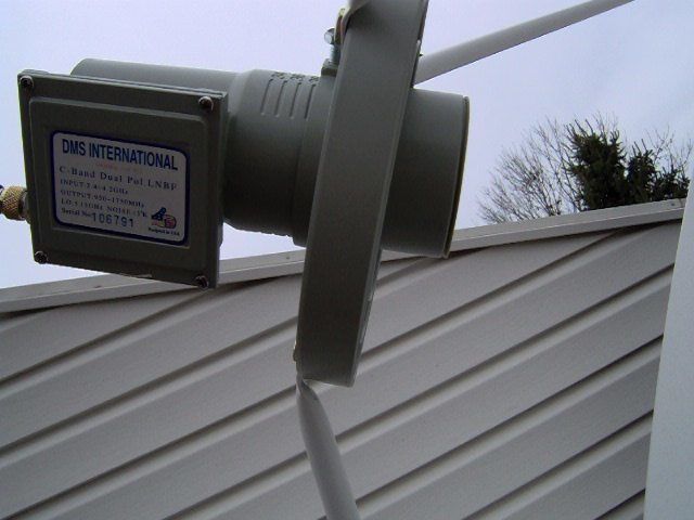

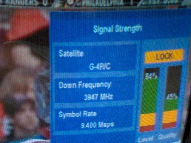

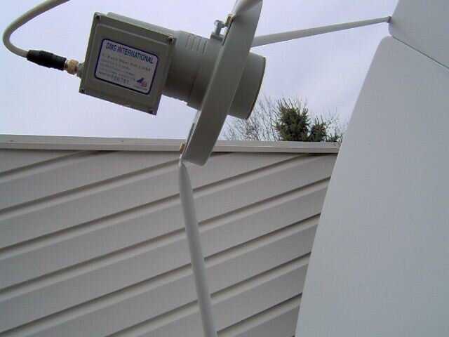

I am so happy right now. Nice WARM day (70+ out) today so in the process of doing my other project (H from G4 and V from G10 into a 3x4 multiswitch...my "is it possible thread" I did some scnning of G4 and got a church channel (I think its living word) at a 16...nets still at 32
so I started working on it. I adjusted skew and it dawned on me.......dumbass, you have skew wrong...you have it to -5 when G4 for you is +5...so I skewed it a little more and it was getting there
Then I remembered what someone said (we're at 24 pages here so I can't remember who did) adjust focal distance.....so I pushed it in a little bit
and a little more...no change
and a little more....and a BIG change....45 quality
OK cool. Now what about the networks (the main reason I got C-Band)
went back there and HOLY CRAP
between a 43-50 quality...a 20 point JUMP!! I cant jump 20 points higher but I was stoked....we're no longer on the threshold. We have a SOLID signal now :)
so I had to push the LNB in about 3/4 to an inch in from being level with the scaler rings.
So for everyone who has helped me with this little project, I say
THANK YOU :clap :clap :bow
I am really happy now that I have a good SOLID signal.
still cant get Casper but it flickers at a 15 quality...enough to pester me letting me know its there but not enough to scan in :):D
