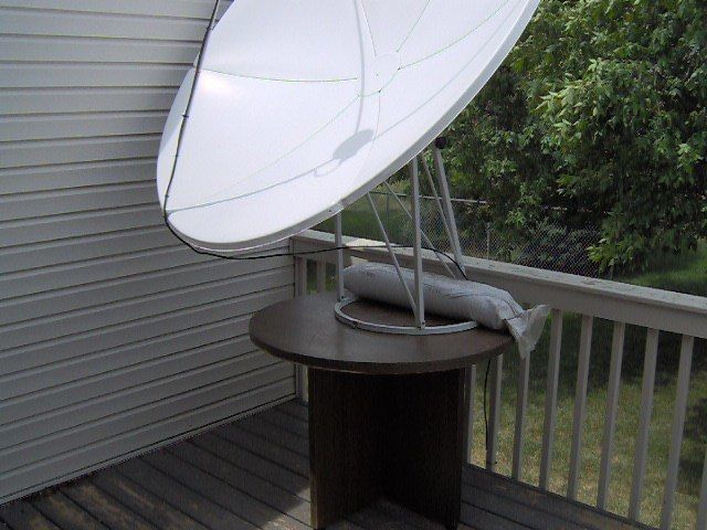

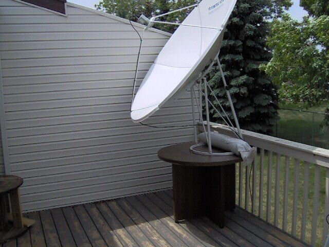

well, did a little work today on it.

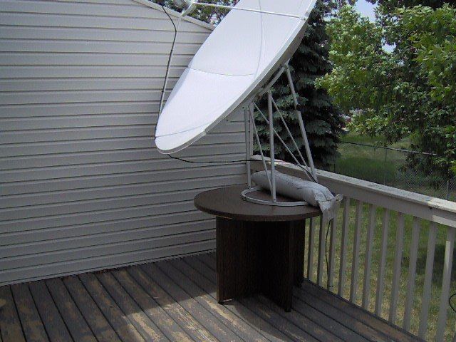

I was using an old cable spool (22" high) to overshoot the roof and it was rotted...really bad. So it wiggled
PSB was nice enough to find an old outdoor table made of solid wood. 30" high
So tonight I build it and heave the C-Band dish on. Aim and in 10 seconds or so signal
tweak it and now I have a SOLID 89-90 on the Pansat (woo hoo!)

pictures :)
(yes the deck still needs to be painted by the Ass'n)
3rd picture shows the difference in height between the spool (22") and the table (30")

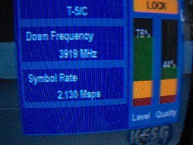

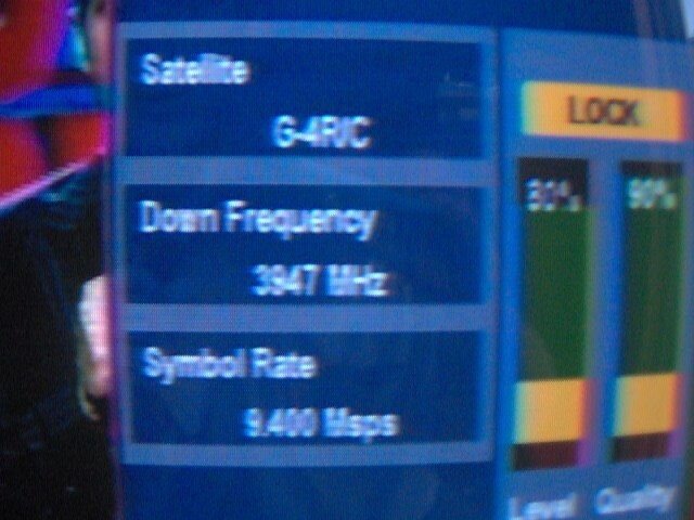

Now I'm pretty stoked.....well sort of
went out to play and wanted to move to T5...picked KCSG tranpsonder...45 (huh?)...hadnt even moved the dish
checked to see if dish was moved....G4 nets...90 :eek:
so my "non 2 degree compliant dish" can get me G4 nets AND KCSG (Independent station) on 2 different satellites.I'm pretty happy....too bad they're on opposite polarities
