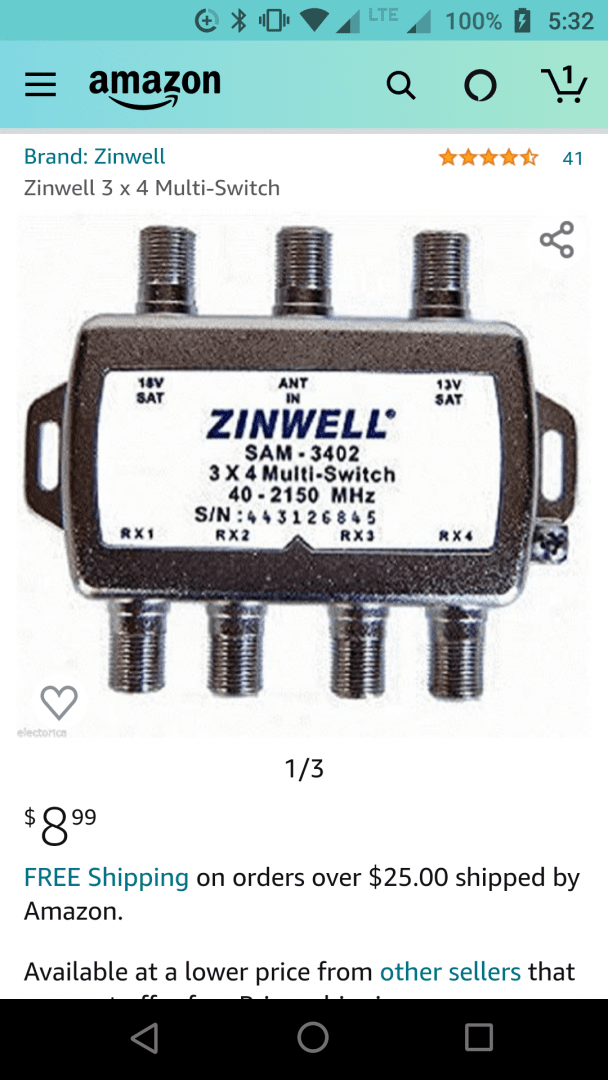

What is everyone doing for adding additional receivers? Can you buy a dual/4 way LNBF that fits the Orby dish, or
just use an FTA dish and LNB?
I believe most of us have been using the Zinwell 3x4 multi switch.. Works great for adding the OTA signals with the sat signal..

I was just going to post but you beat me to it. :rolleyes Yes, no dual lnbf needed. Just feed the Orby coax into the Zinwell (mine is a Zinwell SAM-3402 too, connect to the 13V input) and you can have up to four receivers running. Also use the input for sending antenna signal to the Orbys to tune locals through the receivers. :)

Nice!!! Thanks, just ordered 1 off of eBay
