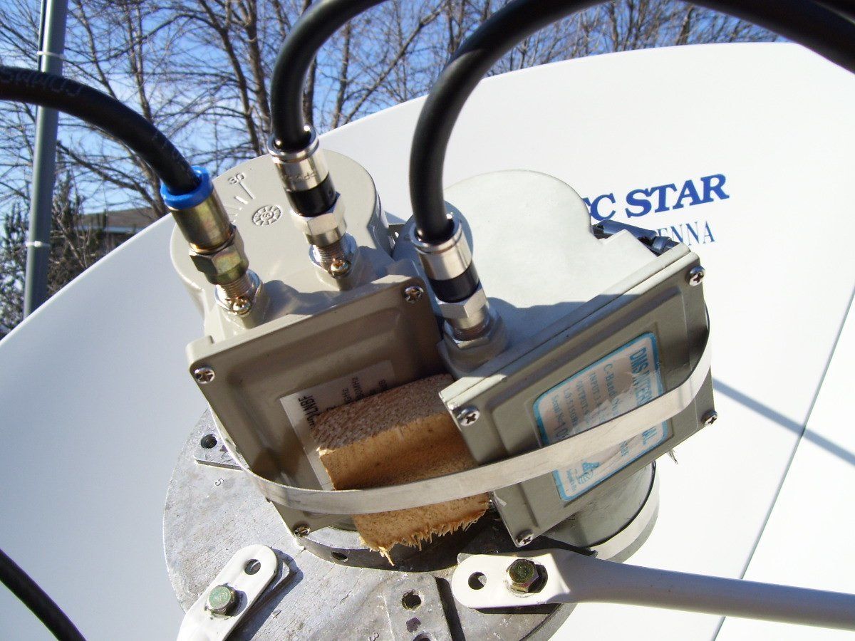

Its kinda hard to see but in the below pic I have the dish at 99W which is 6 off my true south. Note the skew on the left LNB
