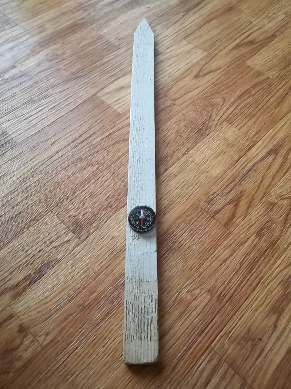

After using those tiny liquid compasses to get an idea of which way South is, came up with this handy dandy compass pointer.
Take an old fence post picket. Make sure one end is cut to a point. Draw a line through the middle of the picket, longways. Take a compass and glue it to the picket so that the compass needle is pointing South and in line with the line you have drawn on the wooden picket. Now you have a nice long reference pointer. See the pic.
You can make it as long as you want, mine's about 2 feet long. I aim it South and lay it on the ground in front of the dish to give an idea of where magnetic South is.

I'm simplistic, I guess...I used to get very close by throwing a broom or similar on the ground in the "extended" direction of what I needed from the compass in my hand for dish installs. Friends laughed that helped me install my dishes on my property, but they were amazed at how quickly we got the job done. I guess it is a bit "silly." I DO like the idea posted here, however!!!

I have a 10 foot long cedar stick that's like 1" x 2" an very light. I use some of those squeezy clamps to attach the stick to the polar mounts of my BUD then I lay a compass that has a straight edge on one side (it folds up and says US ARMY on it) this lets me point the dish (or any dish) to precisely where it needs to be and holds the compass far enough away from the metal in the dish that I get a true reading. I did this many times at my old house with troublesome dishes and it really made a big difference.
