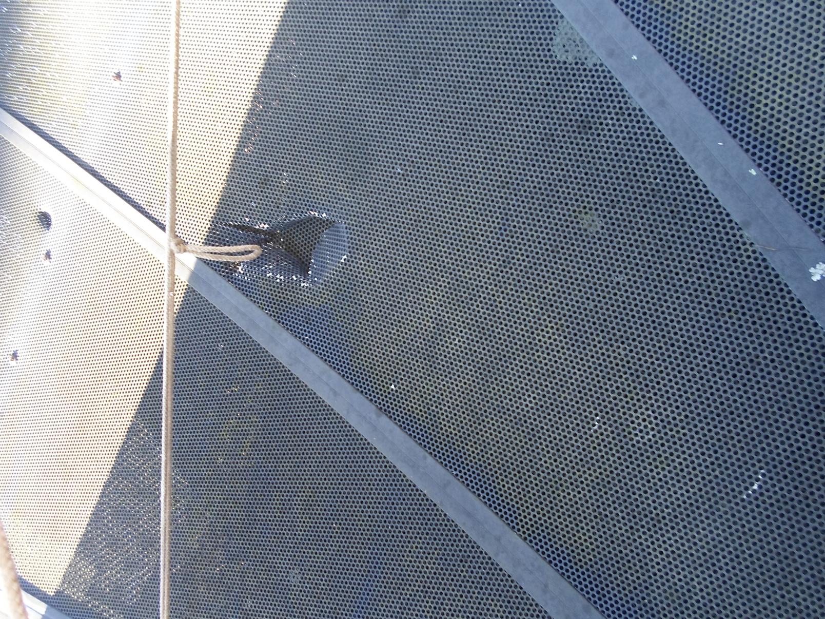

Dish is home and sitting on my truck. :) 10 foot Unimesh perforated with 4 lnb support arms.Press locked,not screw attached panels.Panels don't pop out like the mesh did on the KTI dish. :clapping
Bolts were severely rusted and many had to be wrung off...took longer to dismantle than the 10ft Channel Master prior.Former owner helped the wife and I...really a great guy!

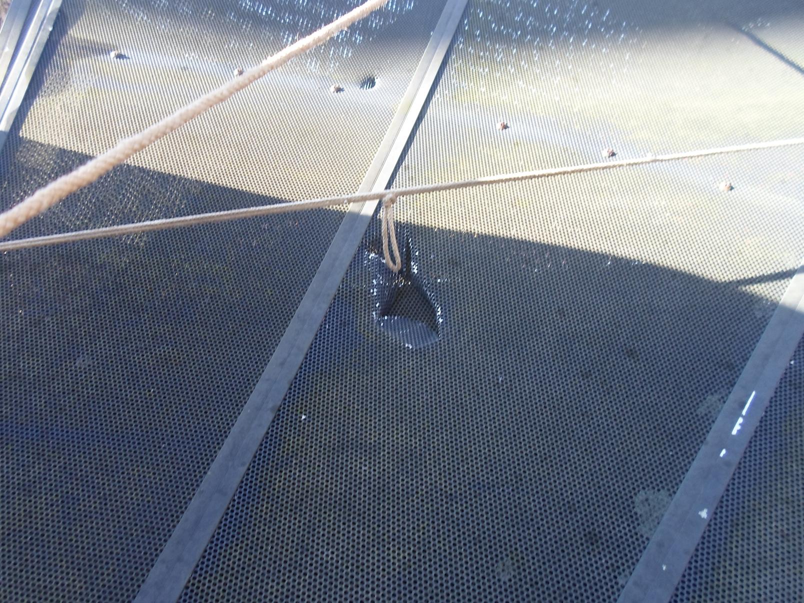

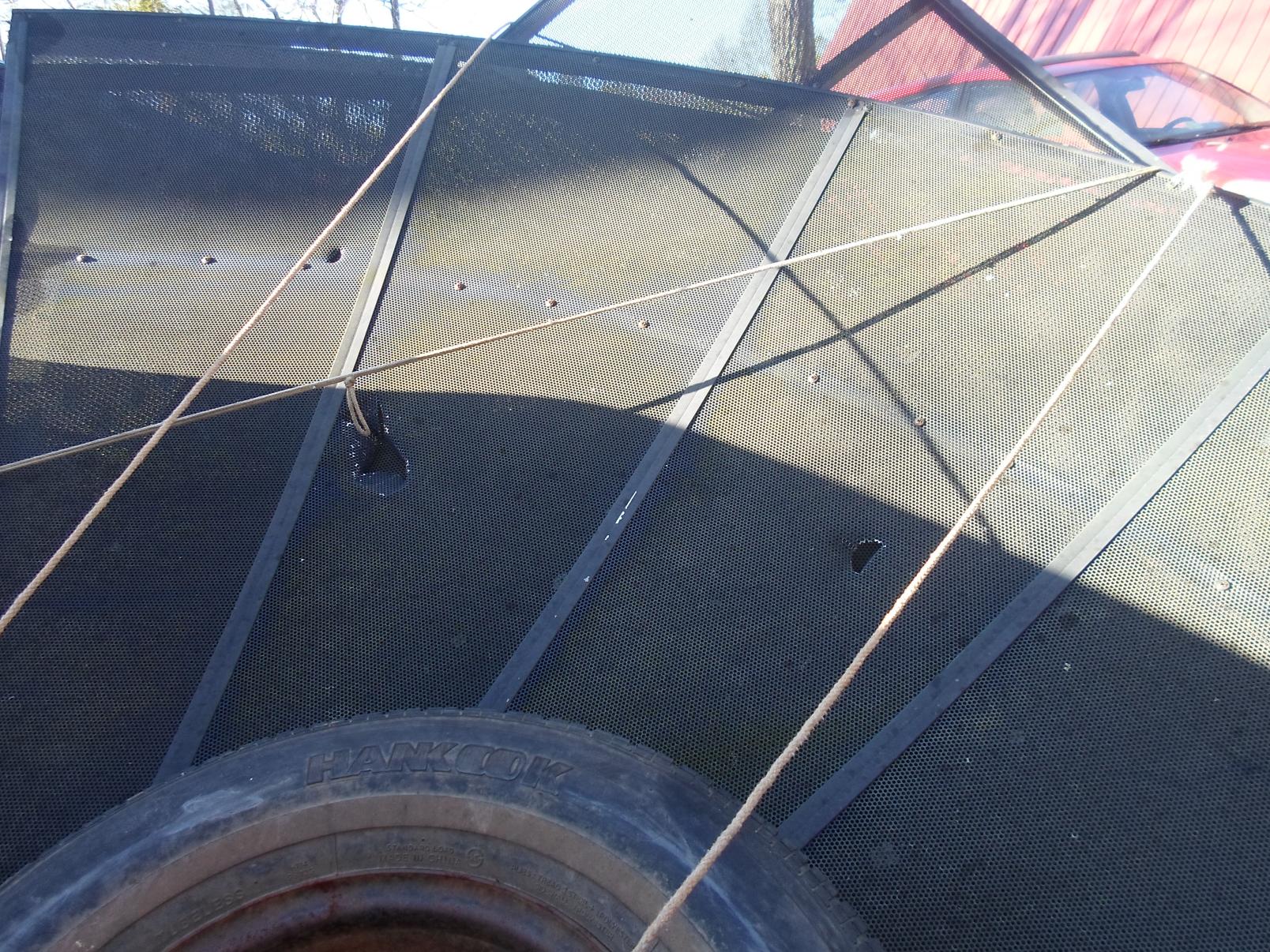

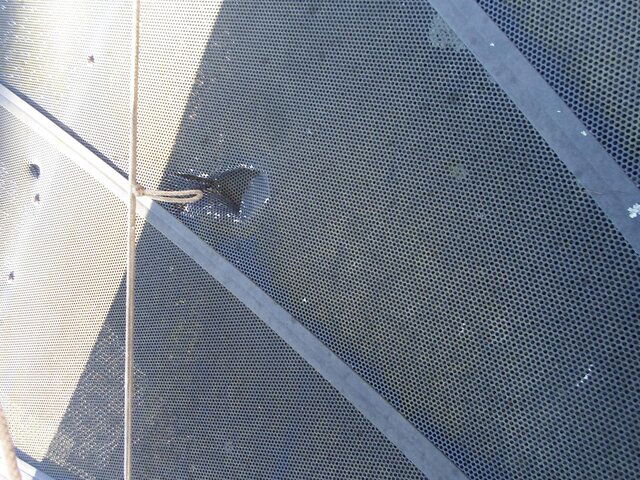

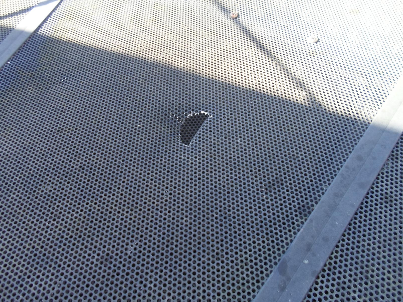

Should I stich up the holes like stiching mesh,or is there a better way? Maybe solder?
I meant to snap some pics before we took it down but forgot the camera.Anyway,here's a few pics showing the one section with damage.(Other panels are stacked behind) First pic is an overview,following pics are close-ups of the same 3 holes:

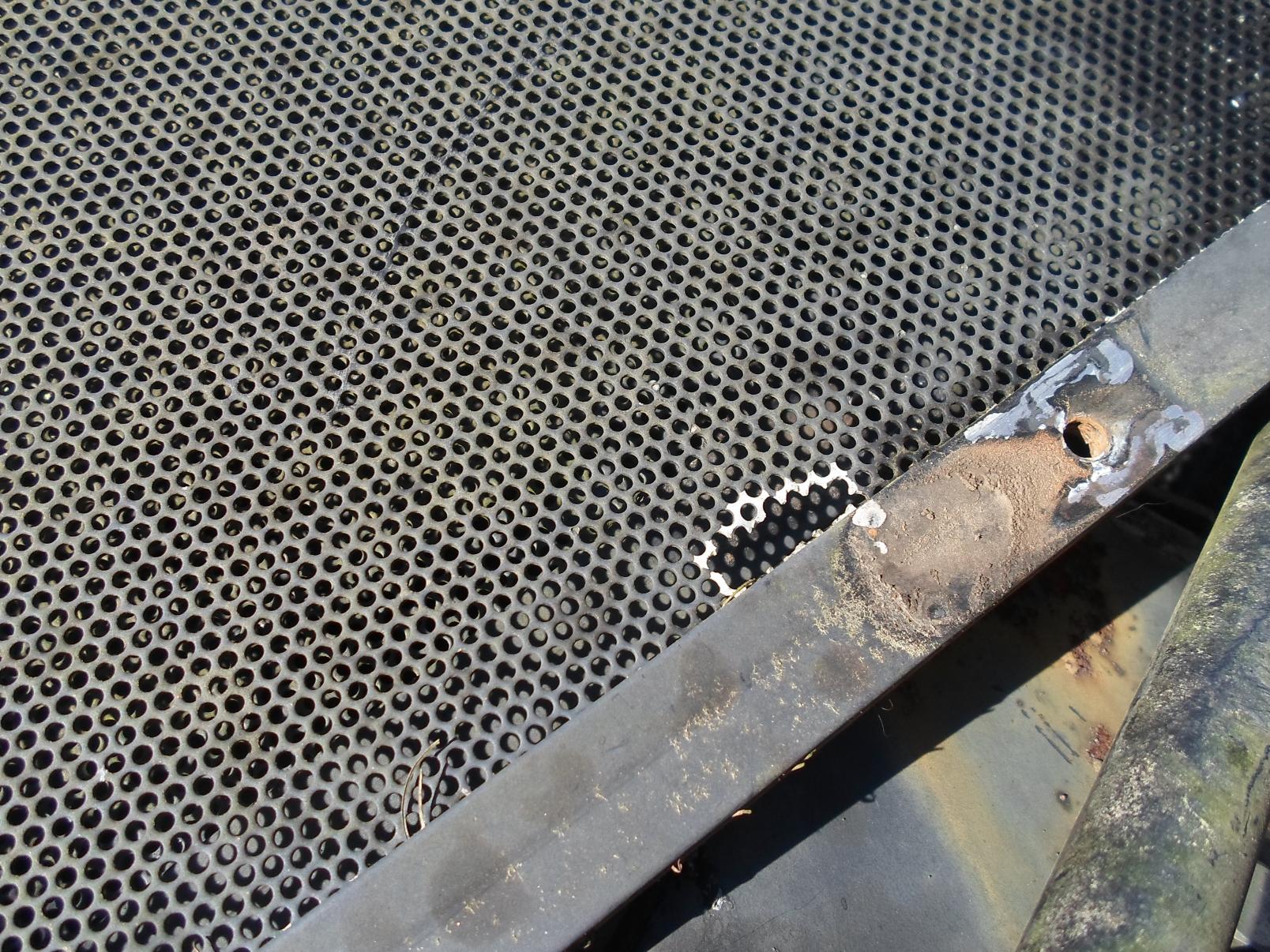

Another small hole not shown in the first pic.Looks kinda like torch melted rather than a punch thru? : Same_Hole.JPG

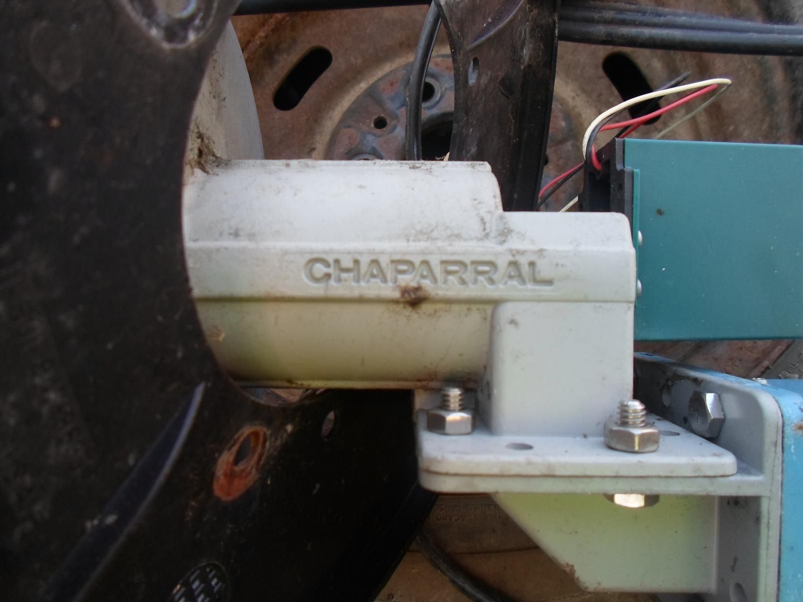

Finally the Chap feedhorn.Lnb is a Drake something,but photo of it was too blurry to post.No plans to use them anyway: Chap_Feedhorn.JPG
I'd stitch the holes, but more for cosmetics, and not performance.
Give them a shot of paint, also for cosmetics.
If the perf panel is Aluminum, use aluminum wire. if steel, steel wire.
(Don't need electrolysis eating at it)
Nice dish BTW.
