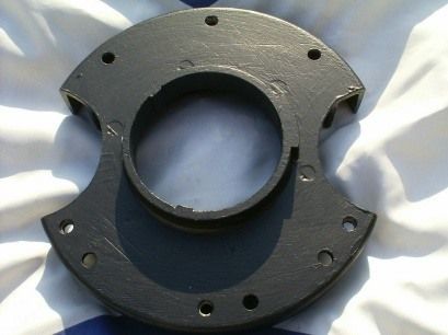

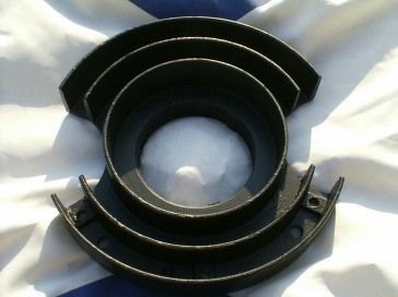

... Did you buy the scalar ring with those LNBF arcs cut out, or did you put it in a milling machine yourself? I have a CorotorII that I'll maim as long as It's safe.
....Just how big is the "area of signal concentration" at the dish focal point? I see your lnbf's aren't dead center on the ring, so it can't be as small as a golfball like I've heard.

Those pictures were from another member, for some reason my pictures never took :)
I cut mine out with a drill a hack saw and a half round file!
