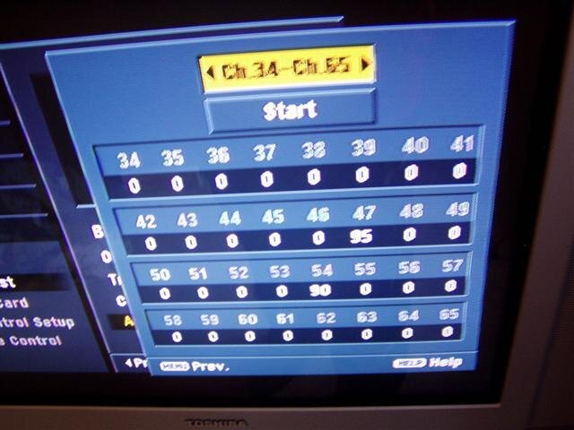

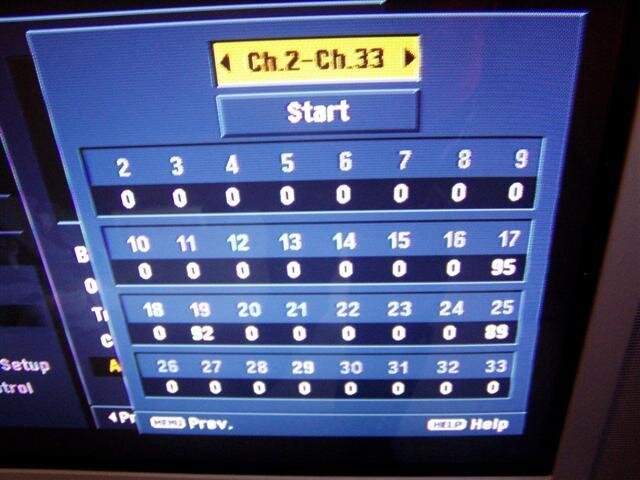

slapped it together in my attic, aimed the sucker, and ran a wire to the tuner.
scanned and all the channels came in 89-95 .

So whats the problem???? All your towers are 6 degrees apart.
Mine are all over the place.

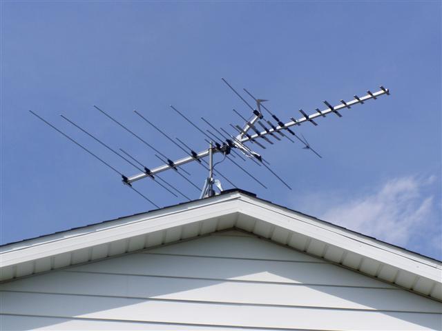

Since you have a digital ch8 suggest a HD7082P see picture below)...outside ...since you are having problems in the attic
or combine a cm4228 with one of your crappy vhf antennas to get ch 8. you can use a jointenna for ch 8 or a cm0549 to get all the vhf in that direction. ..about 40 degrees.
