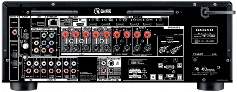

When you say new Onkyo TX-NR676, do you mean new-new, like the HDMI doesn't work out of the box, or is this a case of the HDMI output worked for a while, and then died? Does the front panel light up? You should be able to step through the basic settings and access the HDMI Output configuration to see if anything can be done there.
Looking at the back panel, there are two HDMI outputs like you said. I wouldn't think the Sub output would work since that needs to be set up as a zone (if it's like the NR656). This receiver doesn't have Component or Composite Video output so that eliminates using an analog display. Do you have another TV or monitor that you could plug your TX-NR676 into to see if there is some compatibility issue?
Also, since this receiver has an Ethernet connections, you could try updating the firmware and see if Onkyo might have a fix in the firmware. Again, you'd need to navigate using the from panel display. It may not help, but it's worth a try.
If this receiver is under 30 days old, I'd return it to where you purchased it and get another one. I almost went with this unit to replace my old Yamaha in my family room.
It was hooked up out of the box and without video display output working. I cannot even access the setup menu. I checked all my tv inputs and get video from another source, but get a no signal on the tv when hooked up to the 676. Onkyo says I need all new HDMI cables rated at 18 Gbps. I unhooked all the cables and tried the one new cable that I had and ran a test with various used cables that worked when hooked between the Dish HWS and the tv, but none of them would work with the 676. I ordered some new cables that should be here today/
The front panel does light up. and I can see the outputs change when using the remote.
Well, guess what, I got two wires crossed when hooking up the HDMI. The 676 works fine now that I figured that out. Way too much wiring behind my tv. I have 6 HDMI components.
