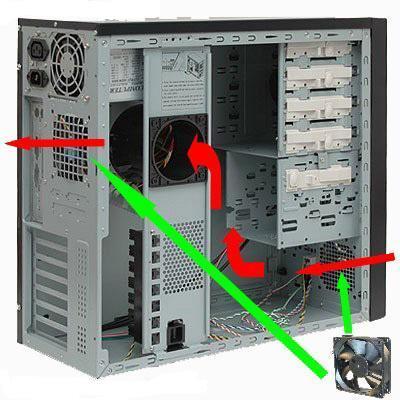

If you are going to get inside you might as well upgrade the processor heatsink/fan (GIGABYTE GH-PDU21-MF) and add additional compound (Arctic Silver 5). Also make sure you have at least 2 high-flow case fans (SILVERSTONE FM121) setup in an efficient push/pull config. See my simplistic push/pull diagram.

What is your fan's CFM?
What is your case cooling setup?
Your CPU fan/heatsink may not be the biggest/only problem and you do not want to bake your CPU.
My case looks like your picture (leave side panel off anyway)

Like Charper said, make sure you have one (at least) case fan set up to pull air into case and one to push air out. The more air flow the better (case fans have arrows that point in the direction of air flow, if you go and buy them, just make sure one fan arrow points in, and the arrow on the other case fan points out of your case after you install them). (note: most power supplies do have a fan, but this fan is really meant to cool power-supply, not enough to pull air through case thereby cooling components and cool the power-supply too.
Another thing about case fans, you can filter the air that comes into the computer, because air is more likely to flow where case fan is, and if case fan on the front is pulling air in, and you put yourself a sponge filter in front of it, it will collect dust/lent, leaving inside of your computer fairly clean. Would just have to clean/check filter often.
