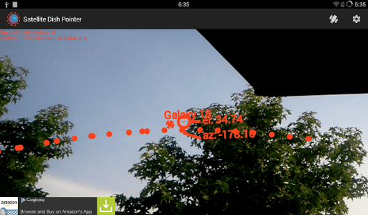

If you have an Android Smartphone I would suggest you try an aiming app instead of the meter.
It sounds like you are way way off in your aiming.
I have had extremely good results with this one:
https://play.google.com/store/apps/details?id=ftl.satellitedishpointer.sdp&hl=en
It usually gets me within 2 or 3 degrees of azimuth.
Then start with the published elevation data for your area.
But most of them are way better than an analog meter.
Even the average aiming app should get you within 5 degrees or so.
As for iPhone I'm sure there are apps but I'm not an Apple person .
Still an app will just get you close, you will still have to search side to side and up and down as suggested.
