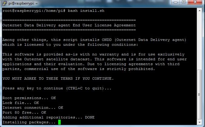

So Far:
1- http://sourceforge.net/projects/win32diskimager/
2- http://downloads.raspberrypi.org/raspbian_latest
3- Burn Image
** #1 to resize sd card **
4- Booted right "Change password" #2

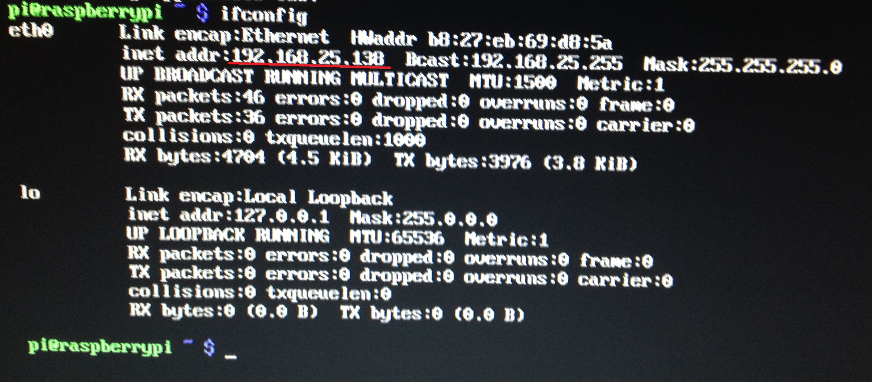

5- Type "ifconfig" to display ip address.
6- SSH in via putty "Username=pi" and password you set
7- sudo su
8- wget https://raw.githubusercontent.com/Outernet-Project/orx-install/master/raspbian/install.sh
9- bash install.sh
10- sudo apt-get update
11- sudo apt-get upgrade
12- sudo rpi-update
13- plugged in tuner
14- rebooted

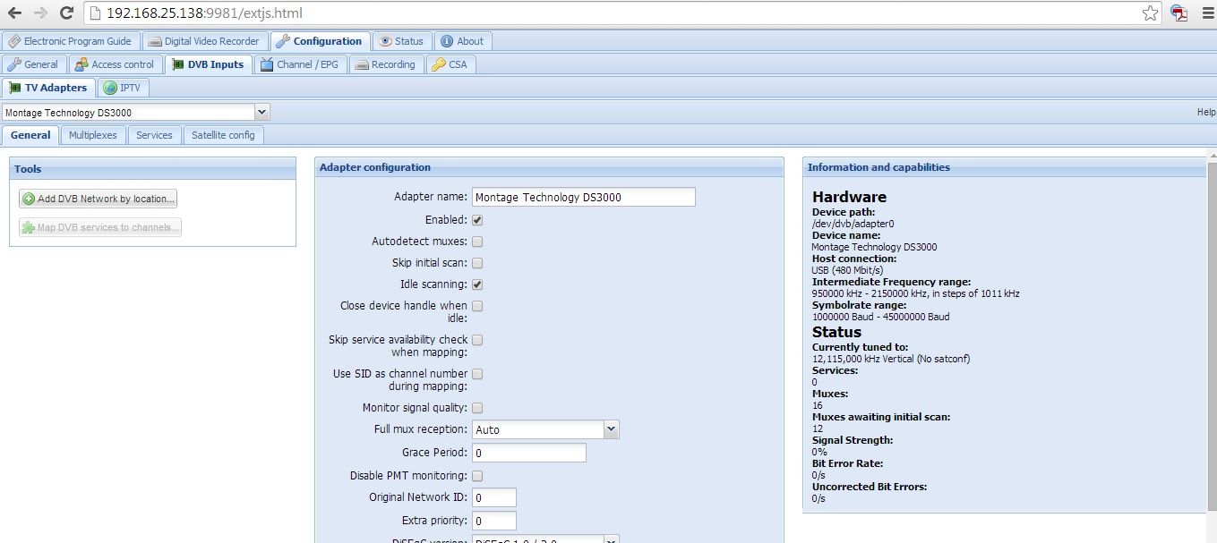

15- http://192.168.25.138:9981/
And we have a problem Houston Grrrr. Going to find USB hub like docs say otherwise i will have to recompile kernel.
typing "df" shows i'm out of space starting over :)
Well I failed for tonight felling asleep I'm out boo
This was driving be crazy could not sleep and bam :)

Had to copy firmware files into different folder.

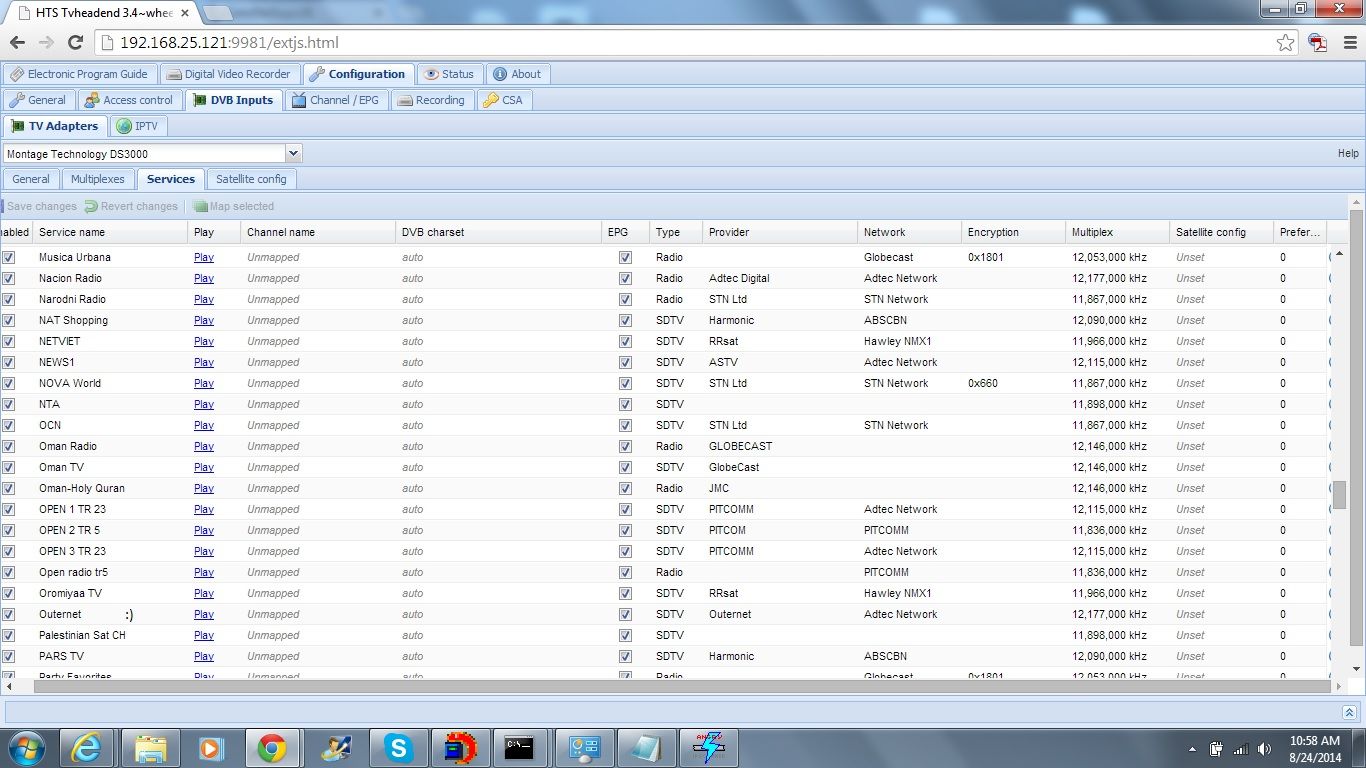

But now its scanning all the Tp's but the one with outernet lol.
Going to let it scan overnight i'm hitting the sack.

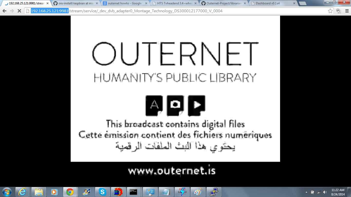

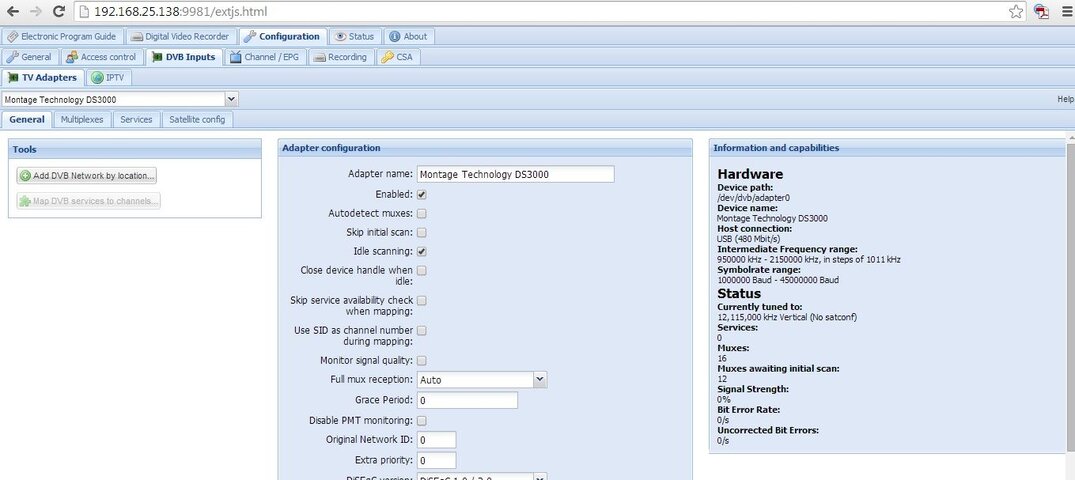

And success :) had to switch from a standard to uni l-104 and bingo.
On to the next issue its playing in vlc.

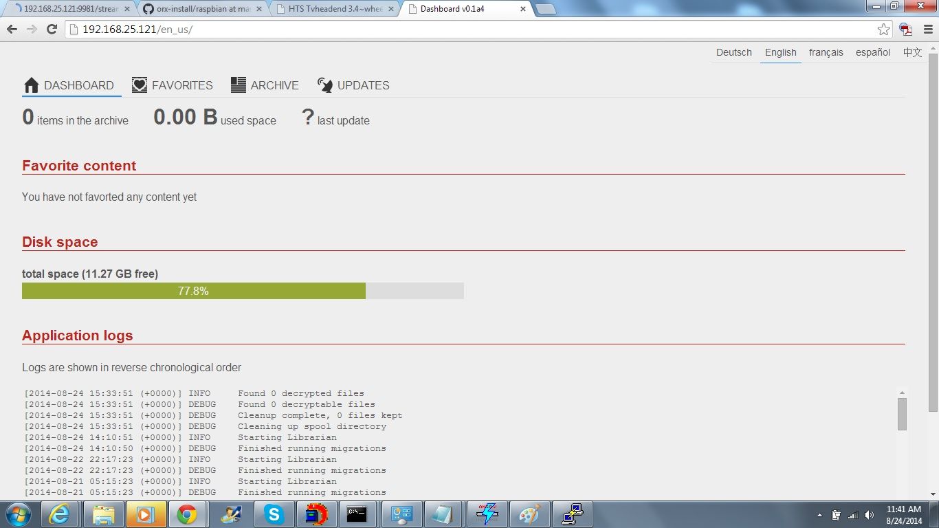

I wonder if there even sending any data under status only seeing 1 to 27 max kb/s

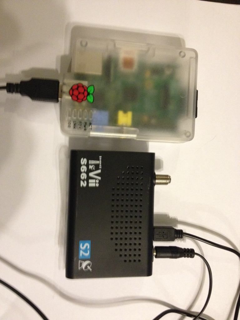

I got my USB tuner today and set this up, so far it has been like you said very low data rates but I have picked up a wikipedia
page.
Reactions: wallyhts
So far I have only picked up a total of 11 wikipedia pages, I wonder if the PCTV 461e is the problem.
