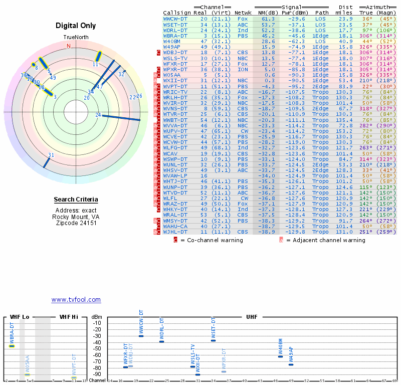

Try this; go to TV Fool - Home, jump through the hoops, do "Save Image As" and then attach the PNG image file to this thread. Or leave us your zip code so that we can look at it.

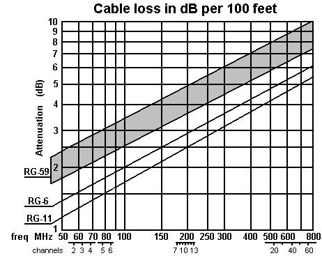

I was just wondering about this myself. Is there a thumb rule, like, 200' of RG6 typically costs 3dB?
Yes, there is; it could be as much as 11 dB at that length. Loss is directly proportional to both cable length and frequency. See the attached chart, which is from Ken Nist's fine antenna discussion in hdtvprimer.com.

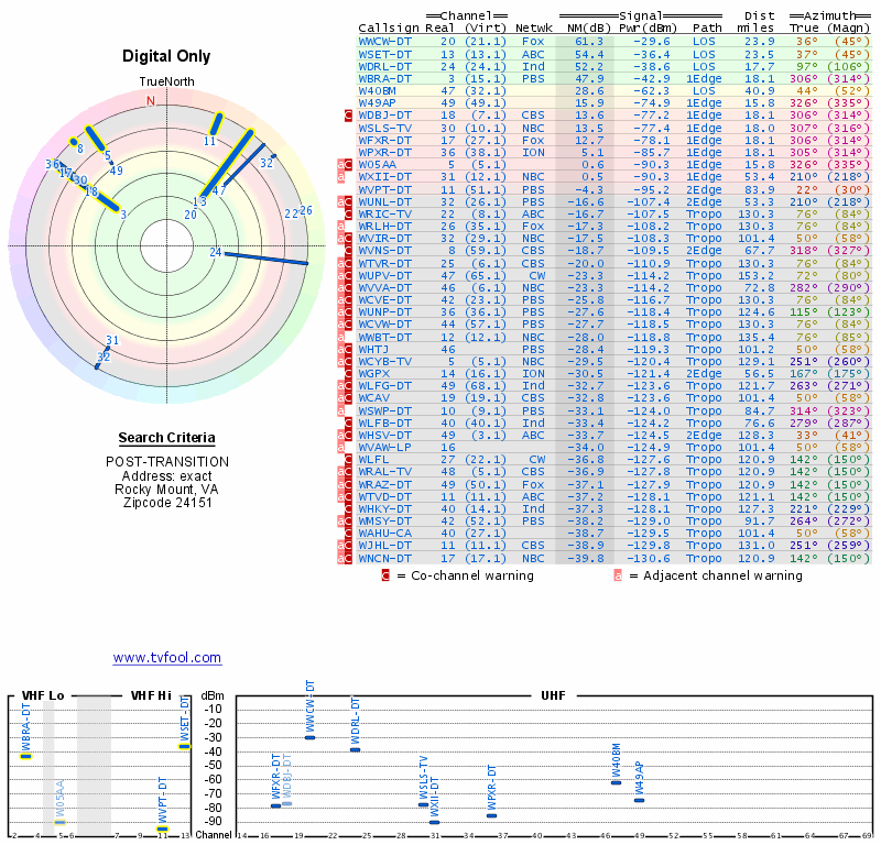

Hate to run you through this hassle, but... Could you please run a post-transition TVFool report and attach it to a follow-up post? Your attachment above contains current signal conditions, which could be rendered obsolete for some of the stations by the DTV transition (whenever that happens!). I'm especially interested in 7.1 CBS, 10.1 NBC and 13.1 ABC; each affiliate is currently transmitting DTV signals in the UHF band but, like many others across the country, one or more may be "moving back" to their original VHF channel assignments once analog transmitters go dark for good. There's no sense in giving advice for a situation that may no longer apply after (allegedly) June 12. TIA.
Here is post-transition
The simple solution is an all channel antenna with a rotor. I'd opt for the Winegard HD-7082P.
The elegant solution is a low band VHF only for WBRA, a 7-69 only aimed at 36 degrees for channels 13 and 20, a UHF only aimed at 97 degrees for channel 24, a second UHF only aimed at 306 for 17, 18, 30, and 36, plus a high band VHF aimed at 37 degrees.
