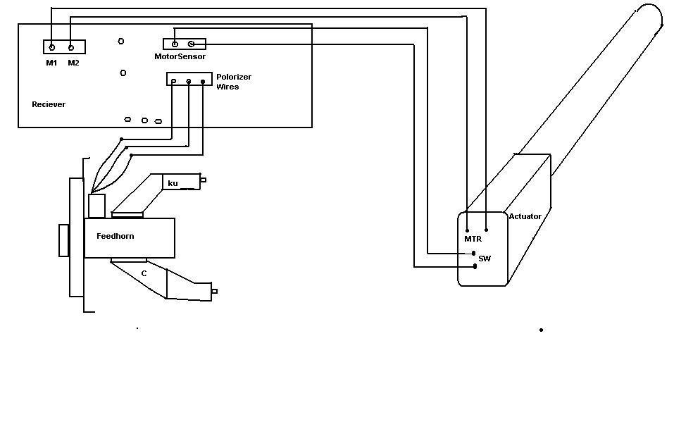

I was given a Chaparral M200C and a Von Weise actuator without any wiring diagrams can anyone send me a wiring configuration so I can hook up this system? Thank you for any help

Try This!
You will have a total of (7) wires needed to hook up most "BUDS"
(2) Heavey Wires 16/14 ga Depending On Distance For The Actuator Mtr - M-1 M-2
(2) Wires approx 22/20 ga That Feed The Actuator Sensor. (pulse/ground)
(3) Wires appox 22/20 ga That Feed The Polarizer (skew/+5v/ground)
Hope This Helps! Cheers! ;) NO1

NO1WOLVERINE, thank you for the info however this chaparral M200C and the von weise actuator, the actuator has 2 #12 wires red and black + 1 yellow, 1 brown, 1 blue and a bare wire, feed horn has 1 white, 1 red and 1 black probably 20/22 ga and we have a small box a chaparral v/h 1 switch
rf input 'a' rf input 'b' one coaxial cable for input on receiver and a hookup for two small wires for power hookup on switch from c to ku? Don't know where to hookup the two wires for this box
