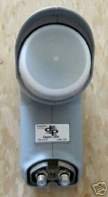

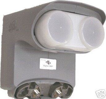

does the dish LNB looks like pic 1 or 2 ?

if its a dishpro you do not need any addtional switches. just hook up the two cables from the dish to the sat inputs on the 322. look up your skew and elevation for the area you are in. make sure mast is plumb. swing dish until you find the 119 and 110 sats. peak signal. tighten down everything and enjoy.
