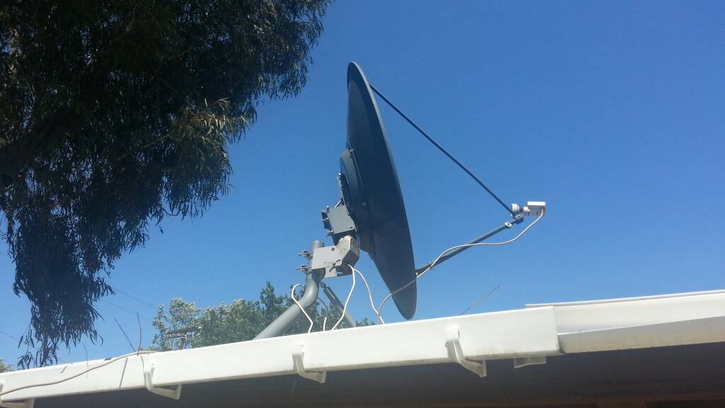

I could only get the pier cameras with my 30 inch Channel Masters. Think the Q was around 70. (Some generic LNBF, I have no clue as to the brand) But the same LNBF on the 1.2, skewed CW ~25°, from 'normal', gets everything at good strong Quality readings.
Skew is facing the dish face.
A Non PLL LNB for me gets it fine.
