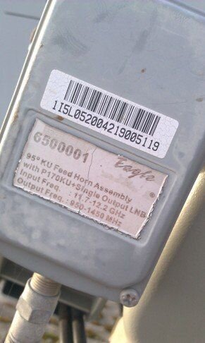

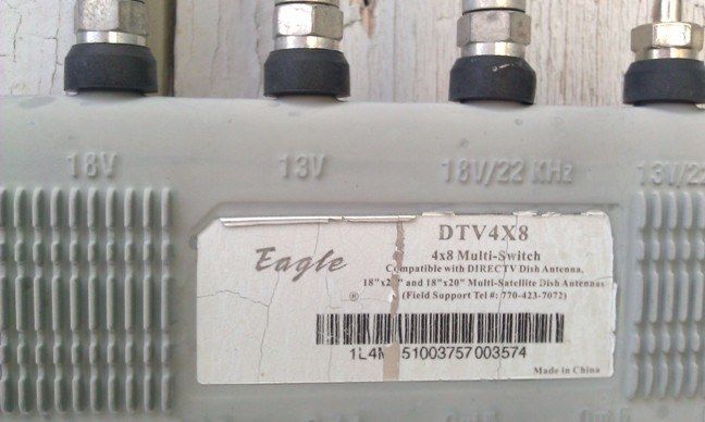

I canceled my DirecTV, and saw that there are postings about using the Worldirect Dish with 97W. I was wondering if I could also use the Eagle Aspen switch that was used in the old setup so that I can use two separate FTA receivers (Viewsat LITE + VIewsat MAX HD) . That oval shaped LNB has a single output, but its going to the switch. I remember the DirecTV tech said, I can have up to 8 receivers, but of course he was talking about DTV receivers. Here are the pictures of the switch and LNB..

Nope. Sorry. Have to use a dual output FTA LNBF. One output is H[to 18v], other is V[to 13v], on the mulitswitch. GEOSATpro SL2 or equivalent. Then as many receivers that the switch will provide outputs to. (2-4-8?) See the sticky Switches Simplified (or something to that) in the FAQ's

The switch: we'll... no, not really.
On WorldDirect service, I believe they use only one polarity on that LNB (but both polarities on the circular LNBF, and notice it has two outputs).
To watch 97, you'll want access to both V & H polarity on each receiver.
There are several solutions... Here are two I'd consider:
- replace LNB with Dish Network FSS LNB; use high frequency, power passing splitter to feed each receiver.
- replace LNB with Dish Network FSS LNB; use DishNet DP34 to feed your receivers.
Wont go into the details and background right now.

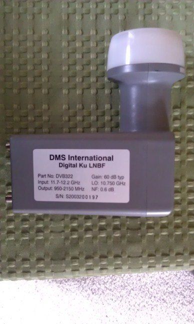

I have a dual output LNB
I actually have a dual output LNB, so can I use it with this switch I have? Also, the LNB on the WorldDirect dish is egg shaped...and my dual output LNB isnt....will that make a difference? thanks everyone for helping me on this.......

Here's the spec sheet for your LNBF: http://www.satelliteguys.us/attachment.php?attachmentid=26571&d=1215667988
courtesy of ?? (found via google)
Being a single output, multiple receivers will be 'locked' onto one, or the other, polarity with existing LNBF.
SL2 and a conduit hanger mount for it, and the existing multiswitch seems the simplest solution (to me) for a multi receiver set up. (maybe I'm 'hung up' on the K.I.S.S. principle?) BICBWrong

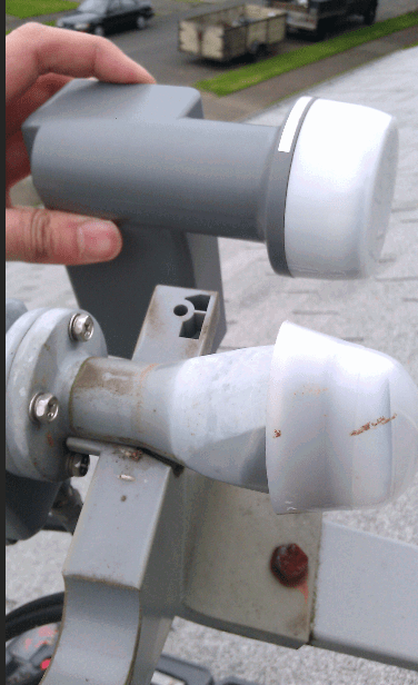

Would there be another (dual-output) LNB that would fit the oval feed? They're held together with four screws, so could someone conceivably swap LNB's but keep the feed?

The World dish LNB as designed for Directv is to only pick up the Horizontal transponders....but it will work fine for one receiver as noted
... And the P270ku LNB listed there is just what the doctor ordered! :)
It's available at Impakt Products:
http://impaktproducts.com/Eagle-Aspen-270-Ku-Band-Dual-Output-Linear-LNBF-ON-SALE-p-16619.html
And, yes, you can use your multiswitch with this LNB to feed two receivers. ;)
That other LNBF you have on the dish, is circular polarity, and not useful for FTA.
Yes... To clarify, that is a C-120 flange on the feedhorn. The same flange interface is used on the Dish FSS stacked LNBs found on Superdishes, on most (all?) LNBs used by Primestar, and many others. It is a common flange, and many LNBs will fit to it, allowing the use of the original feedhorn.
this is great news indeed. Looks like all I have to do it remove the LNB's on the Worlddirect dish and replace them with my own that I finally dug out of storage. This LNB should work yeah?
That is a LNBF (LNB with built-on Feedhorn), which will work electronically but will not interface to the original feedhorn.
To use that LNBF, you'll need to fabricate a holder and remove the original feedhorn.
You would need a C-120 flanged LNB to keep the original feedhorn.
ohh man.. i think i see what you mean...I tried to put my LNB on that bracket, and the neck was too big...it wouldnt fit..(see pic)........so what now?
It would be best to attach a dual polarity LNB, but in absence of the tool that fits... You might just find a 23mm throat underneath all of that plastic case... :cool:
Many LNBFs have a 23mm neck as part of the feedhorn casting. You won't have that beautiful plasic case, but worth checking.
I'd try to keep the original feedhorn and find a C-120-flanged LNB out there. They're not that hard to find, as the Superdish used them. The Superdish FSS LNB is the one you would want, although bear in mind that it is bandstacked, and you would want to use a receiver with the ability to correctly scan bandstacked frequencies.
There are also other, non-bandstacked LNBs that will interface to a C-120 flange. Hughes makes a good one, and these can often be found cheap on FleaBay... Here is one with a feedhorn bolted onto it. You'd just unscrew the four screws, remove the feedhorn that comes with it, and bolt it onto your feedhorn. Be careful not to lose the weather-protecting O-ring that sits between the flanges.
